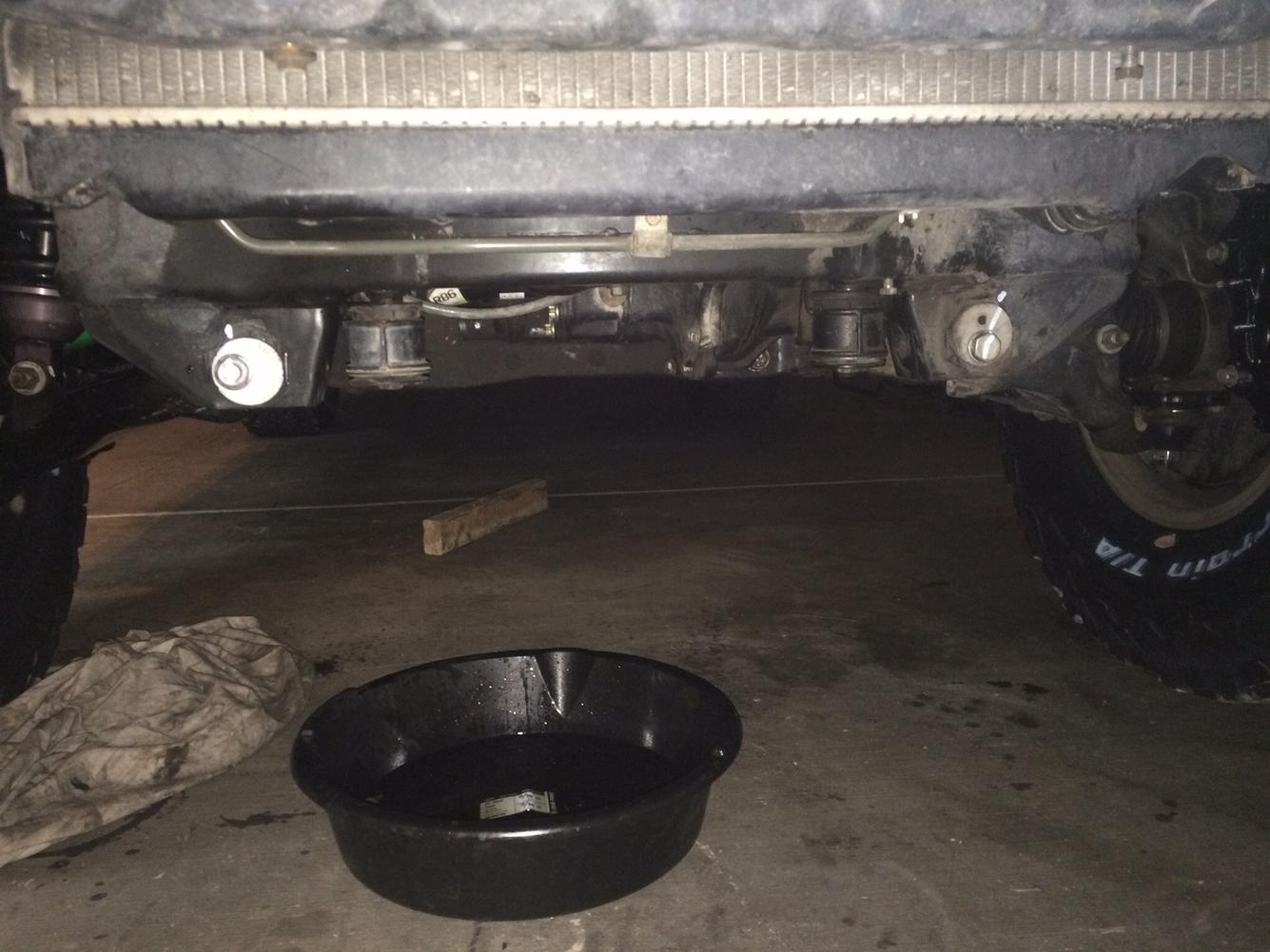

I checked the temps when I got home from work and they were within 10 degrees of each other, in fact the drivers side was a hair lower. So I pulled all the brake lines on the passenger side and blew them all out, they were clear. I bled the brakes again, full bottles worth of fluid and it came out smooth. The brakes are good. I'm really leaning toward something in the alignment.
I said before I installed a carquest, lower arm on the pass side (the only non Toyota part on the entire front end) and now I'm wondering if that could be my issue. The drivers side cams are almost centered front and back, the passenger side is all the way pushed out in the front, and just a hair off center in the back. Why would those be so off from side to side, and front to back? Could that cause the geometry to "change" as the front comes down under breaking load?
Thanks.
I checked all the rear out tonight and everything looks good.
My dad came over tonight just to get another set of eyes on it and another perspective, he noticed something I never picked up on. When you hit the brakes, obviously the truck darts left, but the steering wheel rotates right, like it's trying to correct itself.
Along with everything else I've done, that definitly proves it's not the brakes.
I've already cut the destroyed bushing out of the original OEM A-arm, Im going to source a replacement OEM bushing for it and probably end up putting that arm back on the truck. It seems like the most natural place to start. Thoughts?

Got it FIXED! Sure enough, it was that Dorman lower control arm. I pressed in some new OEM Toyota bushings into my old arm and it brakes as straight as an arrow now! Check out this video I made showing the differences....
