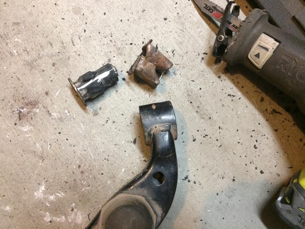

Truck pulls left when hitting the brakes.
The front adjustment cam on that side was frozen inside the bushing and I had to cut it out. I had read all the horror stories about replacing them so I just opted for the "quicker and easier" option of replacing the arm. Huge mistake! Replacing the bushing in the factory arm, actually ended up being fairly easy too.

Ah, gotcha. Glad you got it figured out, and I'll definitely keep this in mind if mine ever need replacing.
Do not overlook:
ABS system. This is often given no look see.
