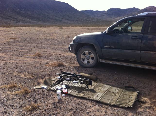

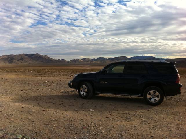

Well since I joined back in 2005 I guess now is a good time to introduce myself, lol. Father had the 1st gen 4Runner, top came off in the summer, hard top went on in the winter and I was the coolest kid in high school. After that he got the 3rd gen and had it for about 8 years but was hit broadside by an X5 about two years ago. Now he's got the 4th gen, 2008 model. In 2005 I bought a 2003 4Runner with 10k miles on it and just absolutely love these machines. I can proudly say that I've grown up in a family of 4Runners. I know its a learning experience but I'd love to take advantage of the vast amount of desert here in Las Vegas, Nevada and finally use this car for what it is built for. My main hobbies are long distance shooting (which having such an amazing truck allows me to get to some hard to get to spots) Muay Thai and Boxing. Here's two extremely plain and non-exciting pictures of my bone ass stock 4Runner but over time I hope to create something with a "wow" factor.

Like lookin' pea shooter ya got there. AI AW or is it an 700 action in a AICS? I ran an AICS for about a year and switches over to a Manners T2-A, little bit easier for positional shooting for me. Any specs on that rifle?
