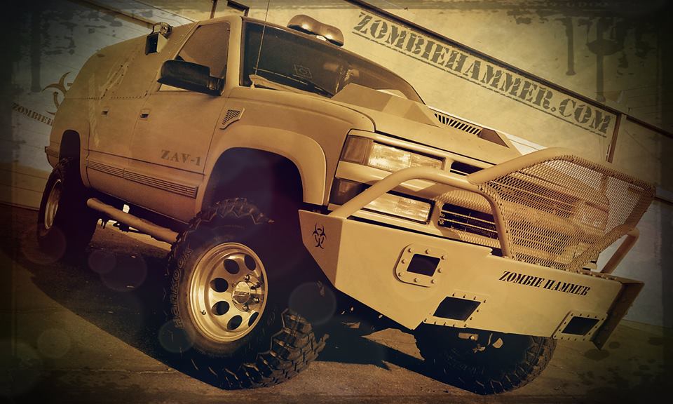

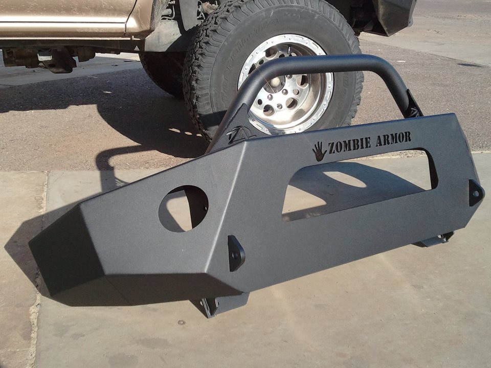

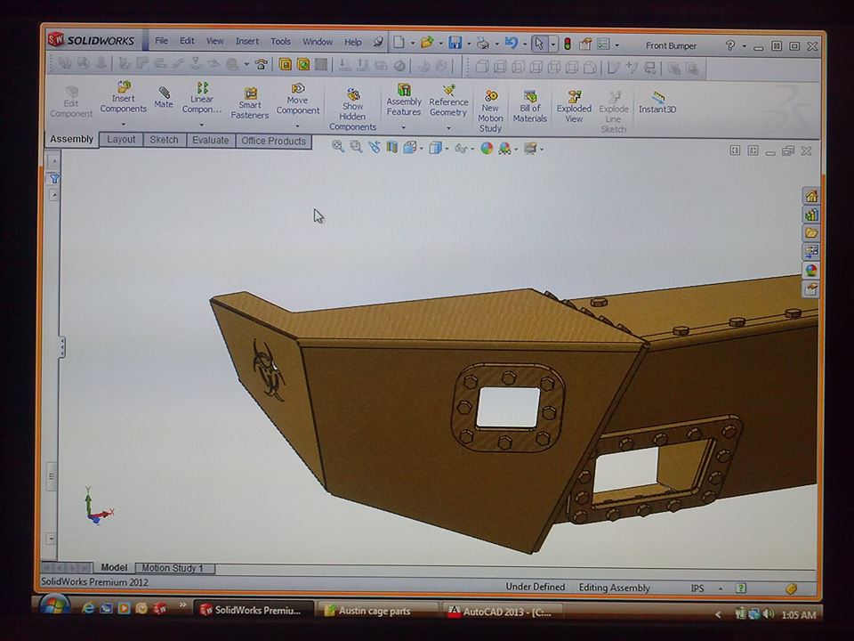

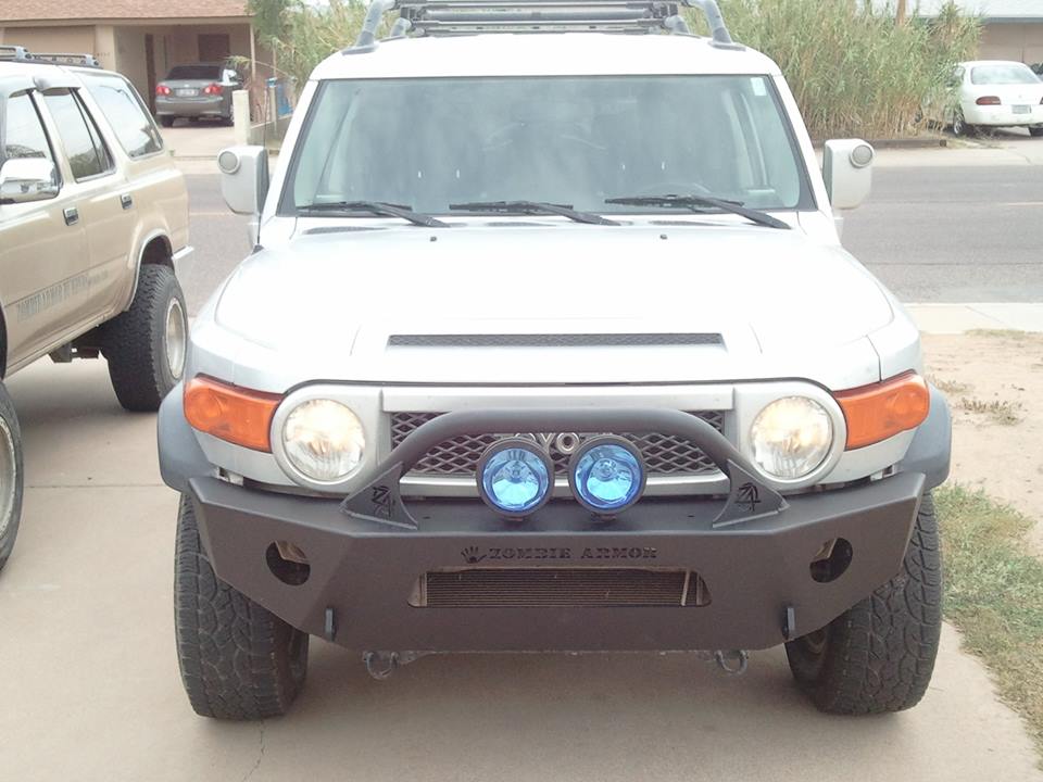

So I have gotten a couple local fabricators that im interested in. They both have agreed to $800 to build me a custom one. Here's one of their work. he will make it custome one of a kind and can write whatever on it if I want. the other guy im waiting on pics of bumpers. I seen his work on tube work for crawlers etc.

Will do [MENTION=24355]SDr6[/MENTION] I'm probably going to go with the guy posted above, the other guy didn't really have any plate bumper style, most his work was tube work. Plus this guy will make it fully custom whatever you want .
