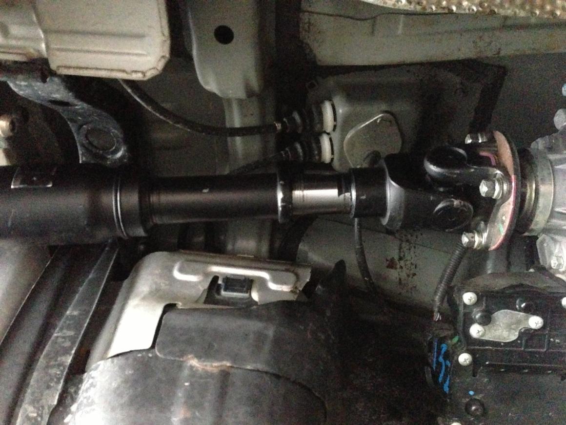

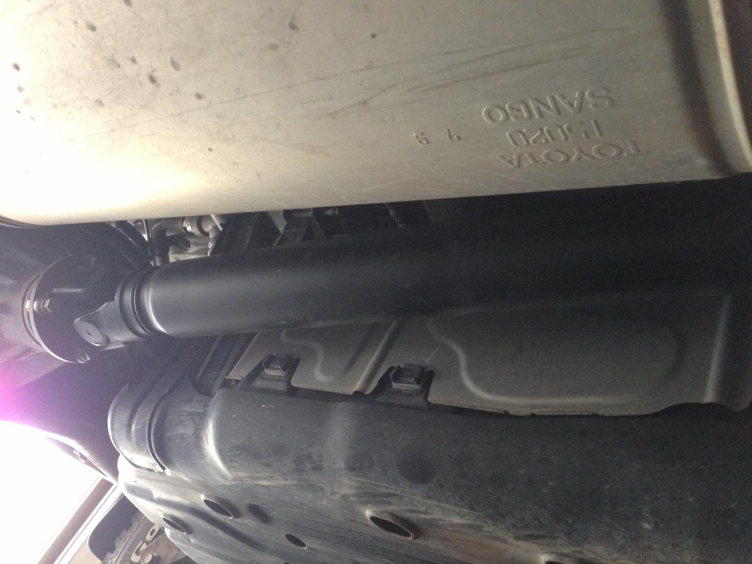

I had the common 'clunk' noise while stopping and before acceleration and a fellow member (Ark_Swamp_Rider) brought to my attention that I could have it replaced under warranty. I am at 40k and got the confirm that it would be covered from Toyota. Obviously with time and more miles I will really see how this new driveshaft does but first impressions are a difference of night and day. Very smooth. Just wanted to share.

I am not sure what the changes are. Maybe someone else could fill us in?
I don't think it is necessarily a "newer" driveshaft. It the one that has been used on the Lexus GX at the same time the Runners where using their version. I think the Lexus one does NOT have zerks and is completely sealed vs the Runner's servicable shaft which has zerks. Dont know too much about it but that is what i do know.
I had mine done and it definitely fixed the issue.

Non servicable throw away drive shafts. What will they think of next...:jk:
I understood that the Lexu$ also got a TSB for it, before the 4Runner, so it probably uses this new type now, but not before. So now instead of a zap of grease, they change out the u-joint. Progress.

Actually the Lexus got a RECALL. Not a TSB. Sucks for us.
Had mine replaced. Dealer I bought my truck from tried to tell me that the TSB "doesn't fix the problem" and the driveshafts were identical and the new one just had some ceramic harmonic deadeners, or some shit like that... Told him to do it or I'd report him to the State for breach of contract on my purchase warranty....
The new driveshaft is lightyears ahead of the old one. 10k miles on it and not a single clunk since it was replaced. This should be a recall for us as well.

i have the updated driveshaft on my 4runner, just had it done a few weeks ago. the shaft is serviceable, the u-joints are not. i posted my findings in an earlier post.
