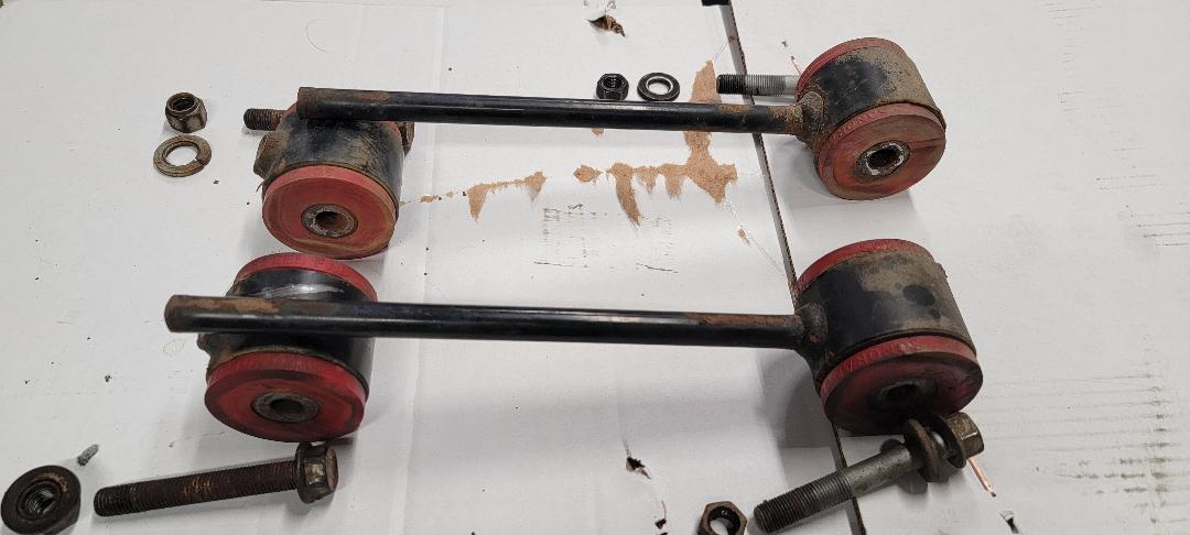

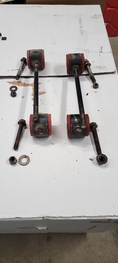

Ok got the UCA's off last night. The more rear bolts on both were very rusted but but came free without any drama. The forward bolts were easy to remove and had much less rust. I doubt they put a torque wrench on them but I also wouldn't say they were way over torqued. (Spec is 59#) All joint were able to be removed by hand without any tools and had reasonably good movement. I doubt they weren't greased at all, however they weren't greased how I would have done it. (As was said earlier if they weren't greased they woulda squeaked like crazy.)In their defense the packet of grease that came with them was relatively small. Let's remember these were on for 3 years, this wasn't an install the bushings and instant snap scenario.
From the looks of the snapped area of the arms it appears one snapped then the other gave at a later time. The arms themselves do not appear to have been in contact with anything causing them to snap. I'm not experienced with welds so I'll let someone else analyze that but the ends of both appear pretty flat to me, so maybe the weld gave? I think the idea that the installer over heated the arms removing the old bushings is at least a strong contributing factor if not the sole reason.
I attached pictures as well

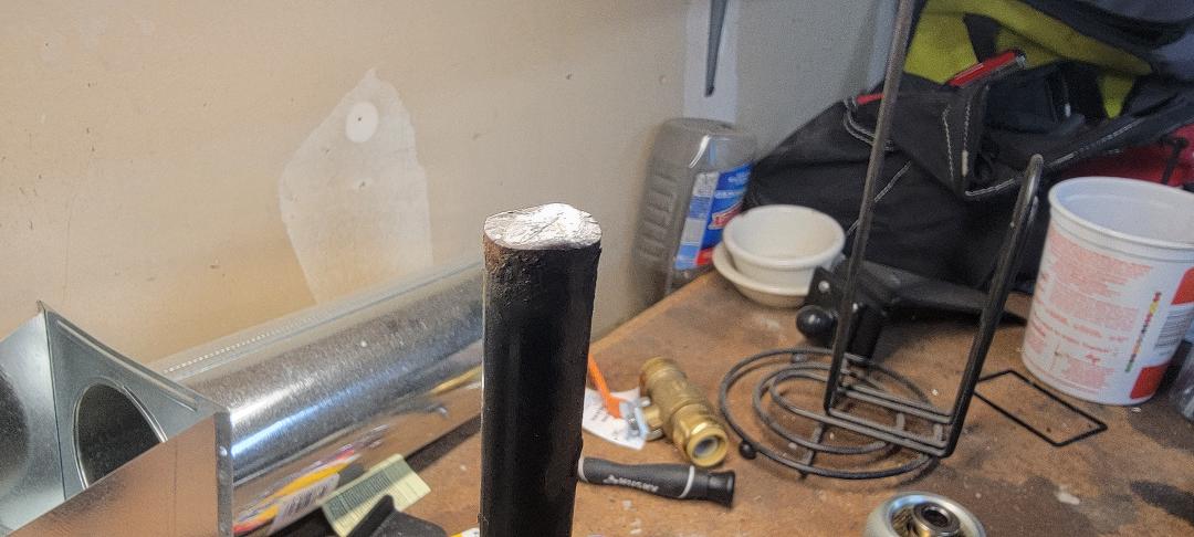

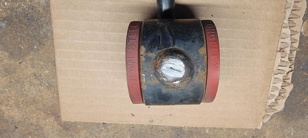

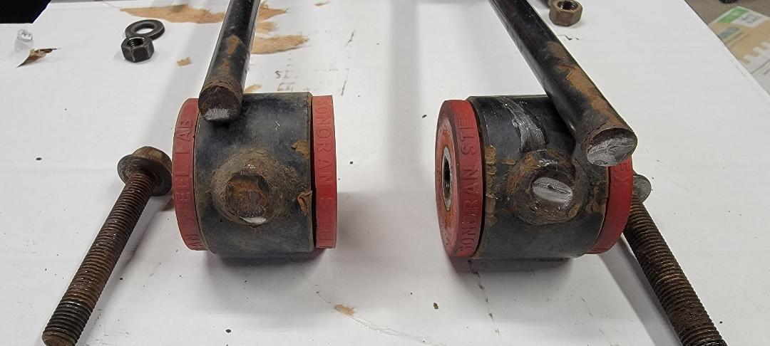

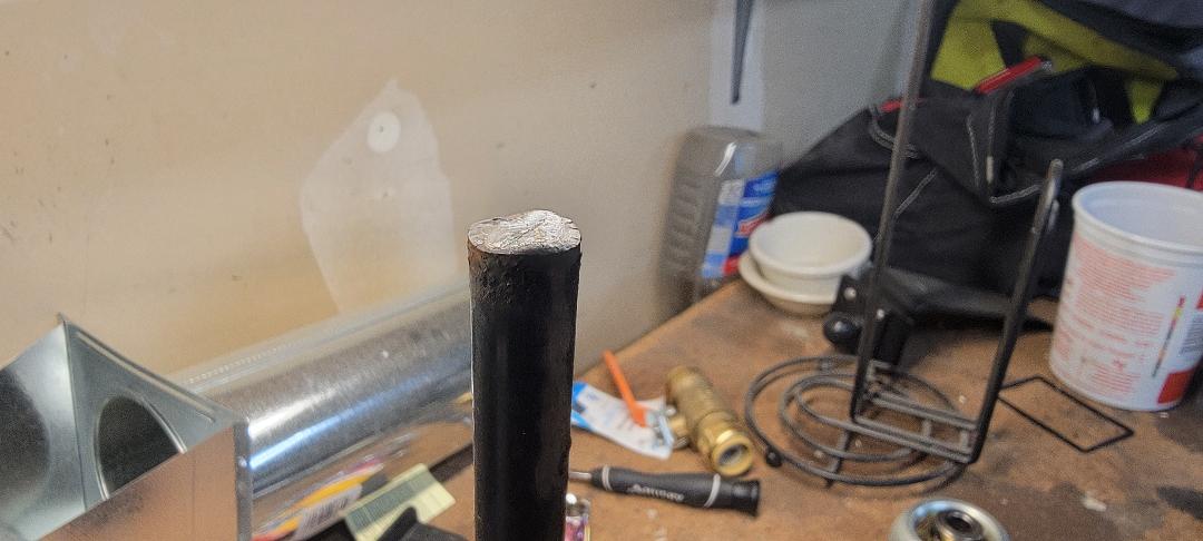

Any chance we can get some high res, well lit, images of the shear area of the UCAs once they are replaced?
Pretty sure I'm running the same bushings in my rear control arms, but only have about 15k miles under relatively mild conditions for my normal use. As mentioned previously in this thread, they obviously don't provide the same torsional flex of the stock rubber bushings, which would likely end up in the failure mode you have experienced
Jeremy, I'm happy to take more pics. Did you see the ones on the previous page? If so give me an idea what more you're looking for.
[MENTION=78273]Jeremy556[/MENTION]
How's this look:

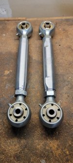

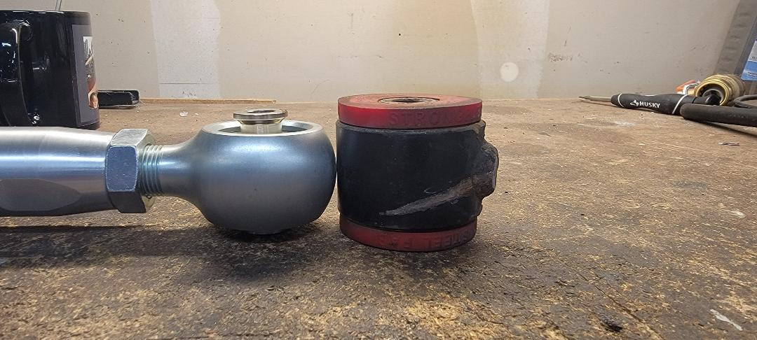

The new joints are narrower than stock, I assume I'll be needing some washers to take up the gap? I can't imagine not having them in there

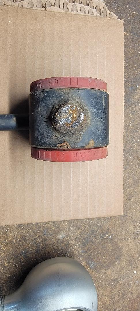

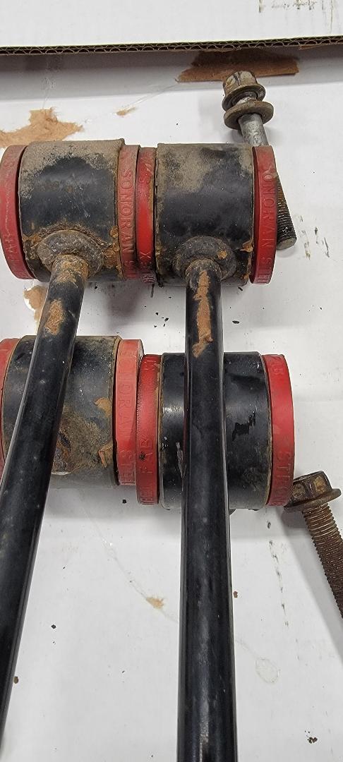

Awesome, thanks. Hopefully some people that are knowledgeable might be able to shed some insight on the failure by looking at the break. It looks like one broke a while before the other with more rust on the broken area.
FWIW - It's very likely the result of the bushings. Poly bushings are not an upgrade in many cases and are not appropriate for the rear control arms. The rear control arms require more complex motion than a simple hinge joint like the front suspension. The ends need to both hinge around the center bolt but also twist axially as the link rotates and flex out of alignment as them move through the various suspension motions.
The flex out of alignment with the bushing pivot bolt is probably what caused this failure. Because the bushing wouldn't flex enough to accommodate the angles needed, the solid rod was bending at the top of the weld bead. That's where the load would be maximum and there's a stress riser. So most likely that's where you started to get metal fatigue after repeated bends, just like breaking a paperclip. And eventually it failed.
Fortunately it sounds like it wasn't on the highway in an emergency maneuver or something like that.
Looks like you have some replacements. I would put some washers in or you may be able to collapse the brackets enough to tighten up. I would not let them float loose on the collar of the through bolt.
Good luck.
You can see some of the classic metal fatigue in those ends, although it's hard without a bit more resolution than you end up with over the forum. There are pretty clear progression zones and then an area of fracture when it broke completely.
I think an engineer would call this a "high cycle low stress fatigue fracture". But I'm not an engineer. So I call it a paperclip break. The main takeaway is that it wasn't from hitting something hard. It was from lots of small back and forth bending over time where the poly bushing wouldn't flex enough and resulted in the shaft bending back and forth.
If it were a result of an instant impact where it pulled so hard on the end that it ripped apart it would look more like this (ductile fracture):
Jetboy, as always thank you for your thorough reply! That makes sense and I'm not arguing at all. But.... if the bushings are the issue and these bushing seem to be a relatively common "upgrade" to the rear suspension. Why is this the only instance I've seen of the upper rear control arms failing?
My bad luck? (That actually makes sense, I am a walking perfect storm) I've run them longer than others? Maybe. (I looked it up I installed them almost exactly 3 years ago, November 2019. about 40,000 miles) It seems really odd to me

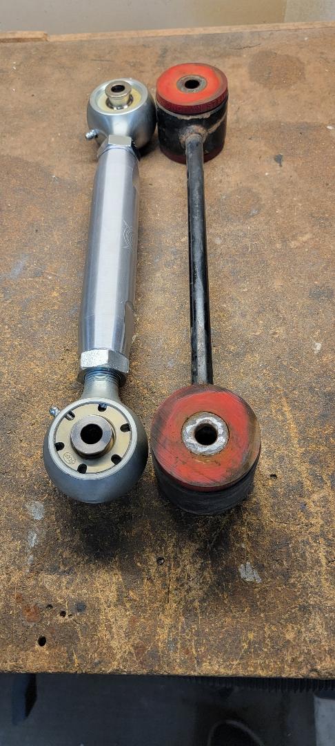

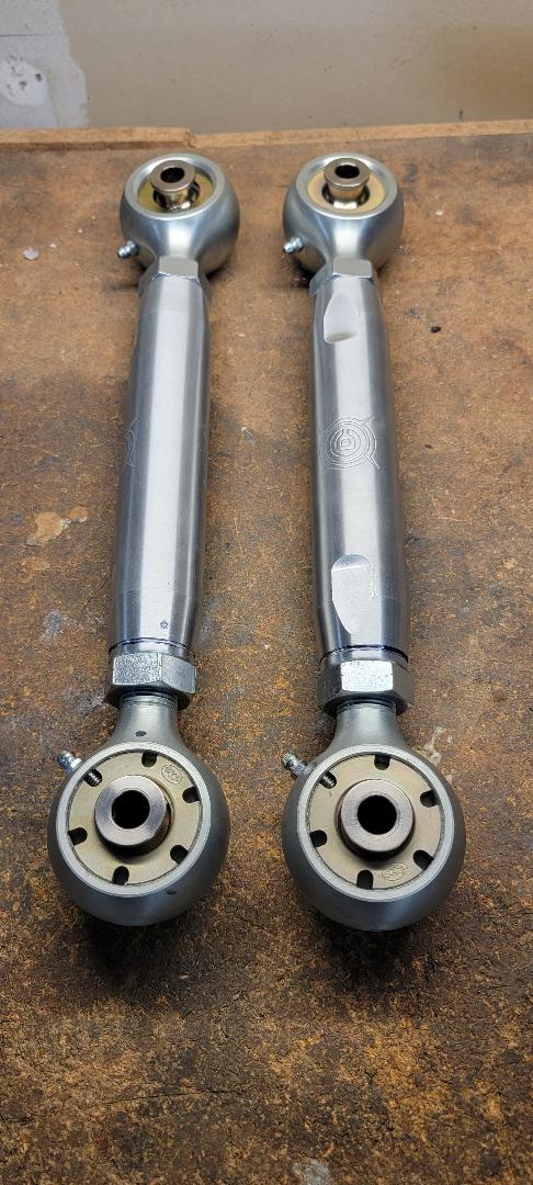

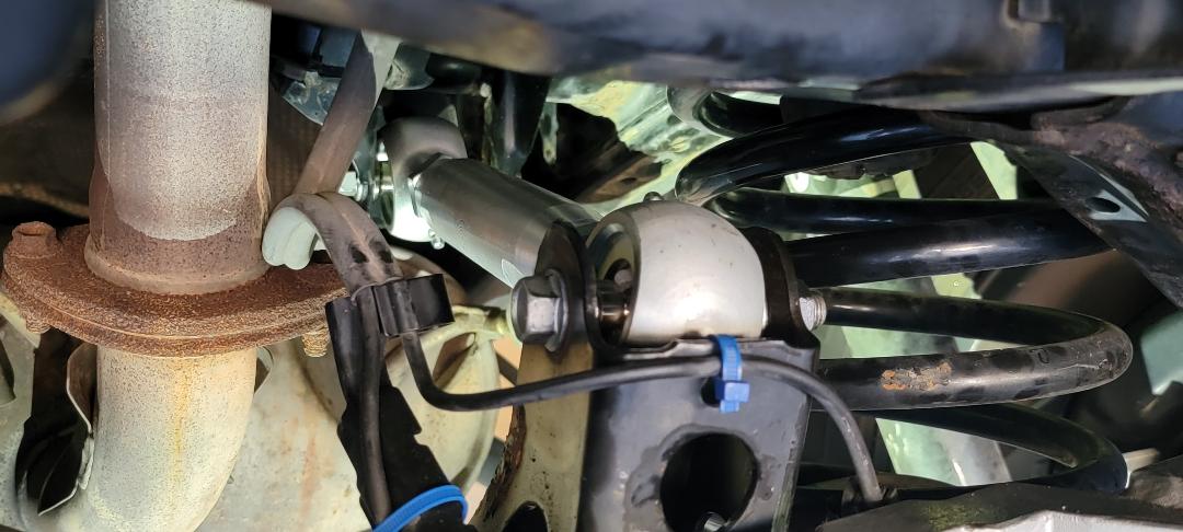

New Arm Installed!
I got the arm installed today. Yes that's right [MENTION=137195]honda250xtitan[/MENTION] you got your wish. Only the passenger side arm installed. However, that wasn't my intent initially. My local Toyota dealer only got me one set of hardware so I could only do one, and I need the truck. I may install the second one later. I did install 2 washers on each joint to take up the slop. Took a test drive and she's running great! Thanks to everyone especially [MENTION=98153]MStudt[/MENTION] for getting these to me on the fly.
Mike these are really well made and really competitive in price. I'd recommend them to anyone who's interested. I'll report back as time goes on regarding performance and maintenance.

Thank you for the business! I'll have to look into why these are narrower than yours since they match the width on my 2019.

I think most people who put them in don't cycle the suspension very far or very often. If you have extended travel rear shocks, that would also add to it. Most of the damage will occur when the suspension is fully articulated. You can probably go lots of highway miles and never have an issue. It just boils down to number of cycles and the amount of deflection. So... take it easy, spend more time on the highways. And you'll be good to go! :P
You are 100% correct.
The inner shaft of the heim should be torqued solid to the mounts, so use whatever (washers, tubing) to make a snug fit and then torque the thru bolt properly. The inner should not move at all.
