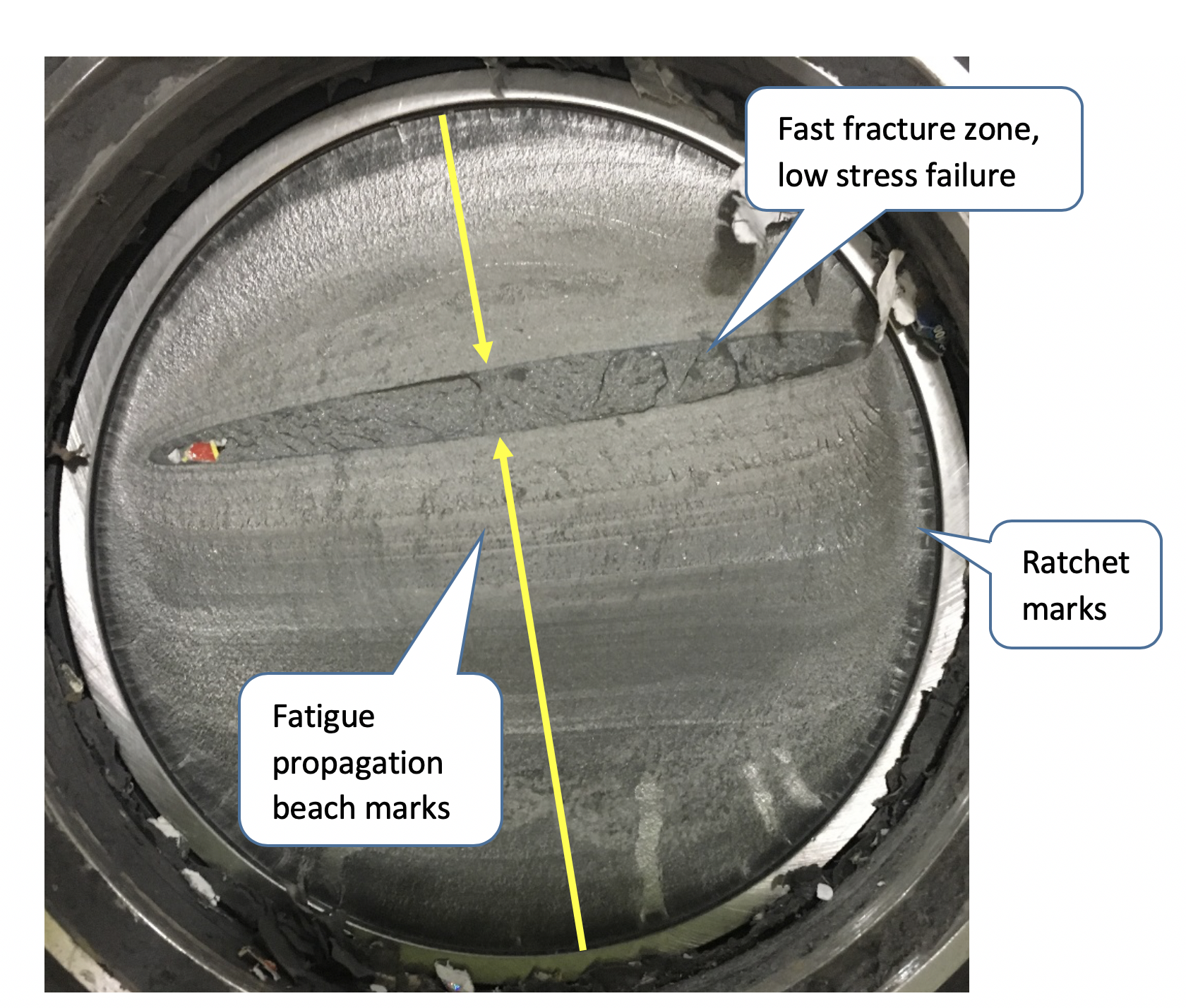

You can see some of the classic metal fatigue in those ends, although it's hard without a bit more resolution than you end up with over the forum. There are pretty clear progression zones and then an area of fracture when it broke completely.
I think an engineer would call this a "high cycle low stress fatigue fracture". But I'm not an engineer. So I call it a paperclip break. The main takeaway is that it wasn't from hitting something hard. It was from lots of small back and forth bending over time where the poly bushing wouldn't flex enough and resulted in the shaft bending back and forth.
If it were a result of an instant impact where it pulled so hard on the end that it ripped apart it would look more like this (ductile fracture):
I am an engineer and I once worked with an engineer who diagnosed a situation where bolts on electric transmission line structures were failing in a similar manner. You basically nailed the situation. Thanks for explaining it in clear terms!
