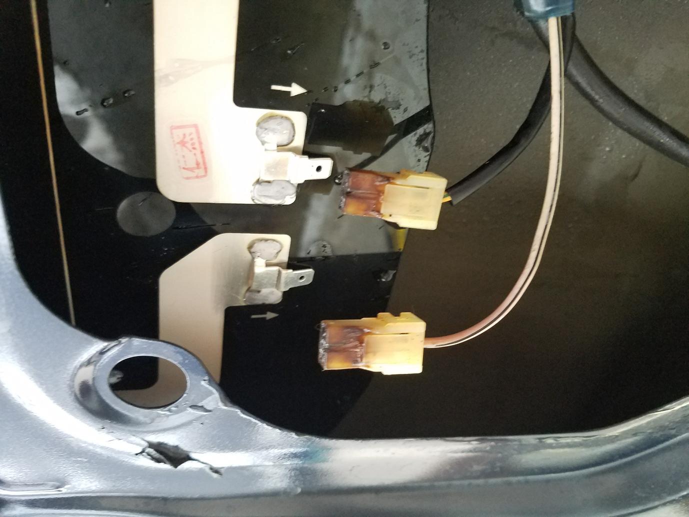

I had my back hatch explode. When getting it replaced, we found the leads to the defroster burned out. See picture. Other than the glass, is the repair to fix the burnt out parts covered?
You don't have to replace them , it's corrosion build up similar to what happens to battery terminals. Mine looked exactly the same.
You can use Battery Terminal Cleaner, it's like a dissolving foam, just spray inside the connectors and let it soak for a bit. Clean off with duster spray or compressed air and it'll be good as new. All that dark stuff will be gone. Apply dielectric grease before reconnecting. It'll prevent the buildup in the future.
My defroster used to take forever to heat now they work like new again.
the connectors are not weather proof so this will get damaged if water/condensation enters the window well area.
what I would do is find some HD connector to slide on that window heater lug then use some liquid tape and cover that connector so water cannot get to the metal conductors.. also solder the new connector on the wire .
silicone dielectric grease does work great in a sealed connector but this is NOT sealed which is why it is prone to failure in this environment .
