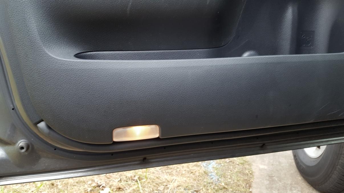

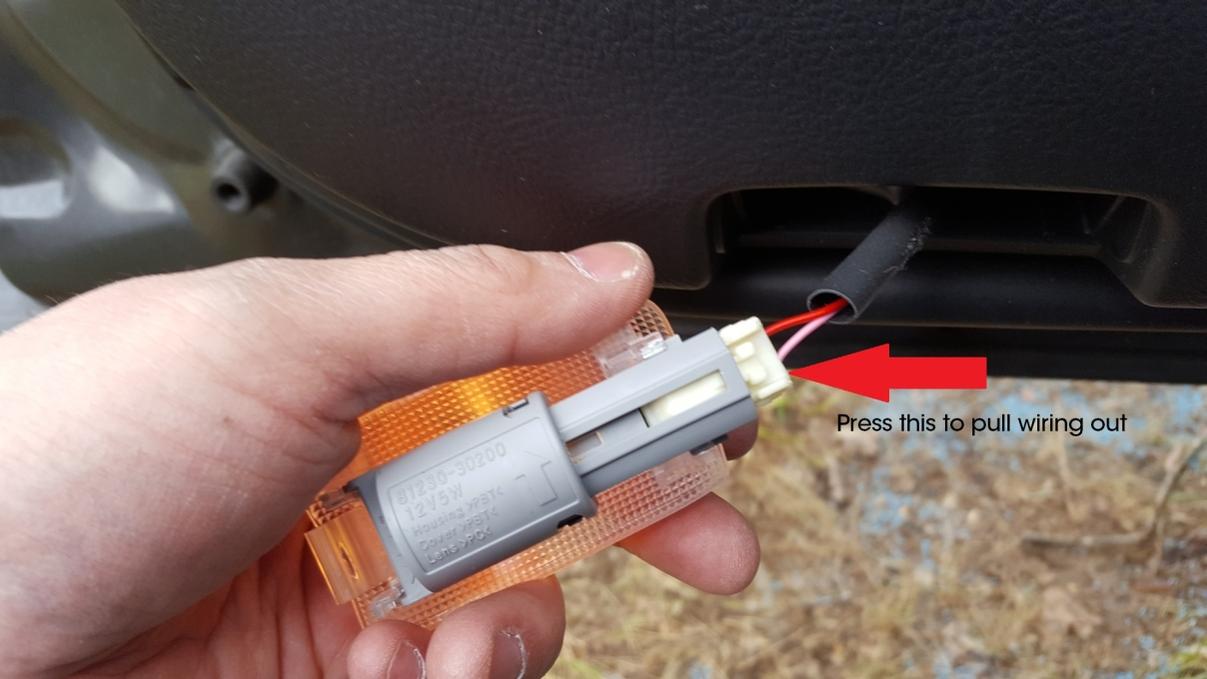

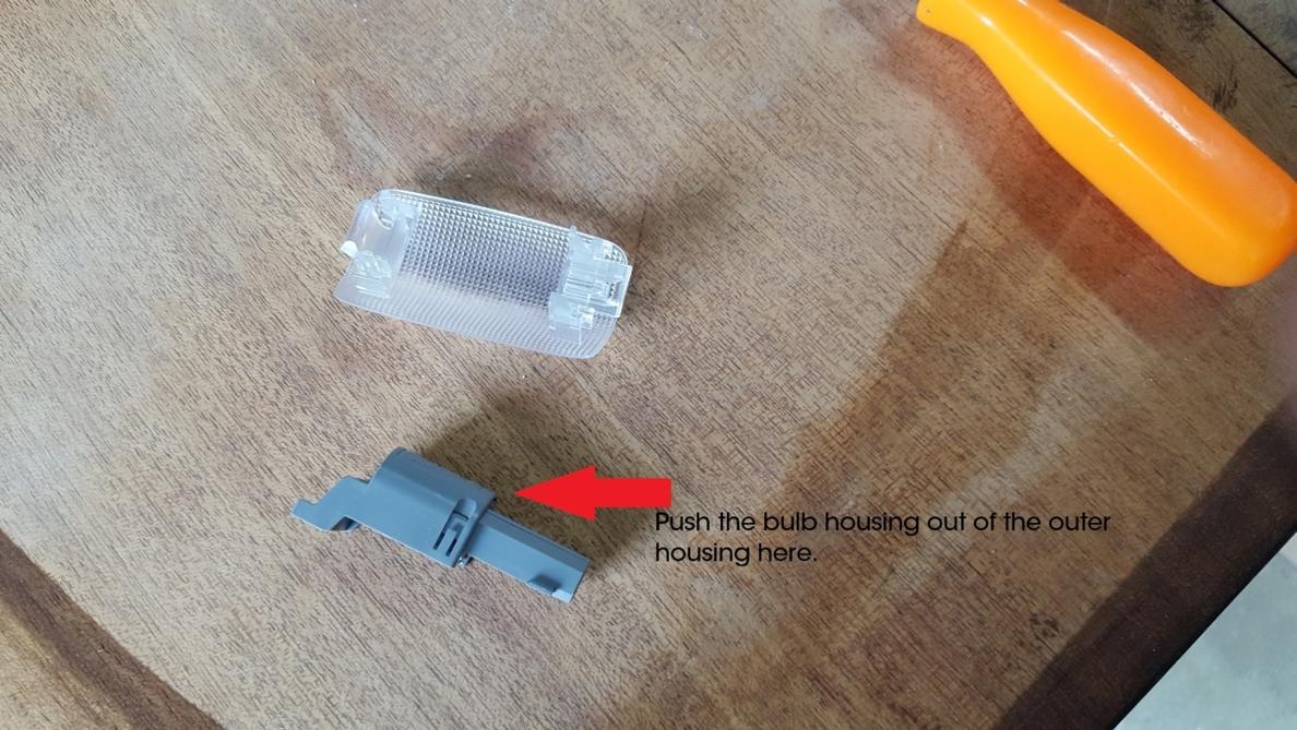

I replaced out all the interior lights, well almost, with LEDs. Like I wrote earlier, I am not handy at all, so this seemed like a pretty easy project... and it was for the most part. I watched a bunch of videos and ordered a set of dash installation tools too. The LED set was from HID, which I like overall. I thought they would be a little brighter but I got warm white instead of cool white, which might be why. It wasn't so much about the color but also to see if I could really do it.
So far, I haven't been able to get the map bulbs out. I've tried all the tricks - electrical tape, scotch tape, painters tape. Just can't seem to get them out but will try some more in the next few days. In one of the videos, the guy just plucks them out with his fingers. Hmm nope. If anyone else has any great ideas about map bulbs, I would appreciate it!
Below are some pictures and commentary for the door lights. Just a little tricky [for me] to get the housing out of the lens. Once I figured out the first, all the others were super easy.
Also, a few of the bulbs weren't working when plugged in. I learned that the wires where the bulbs seat into the housing weren't quite in the right place, so just moved them a tad over.

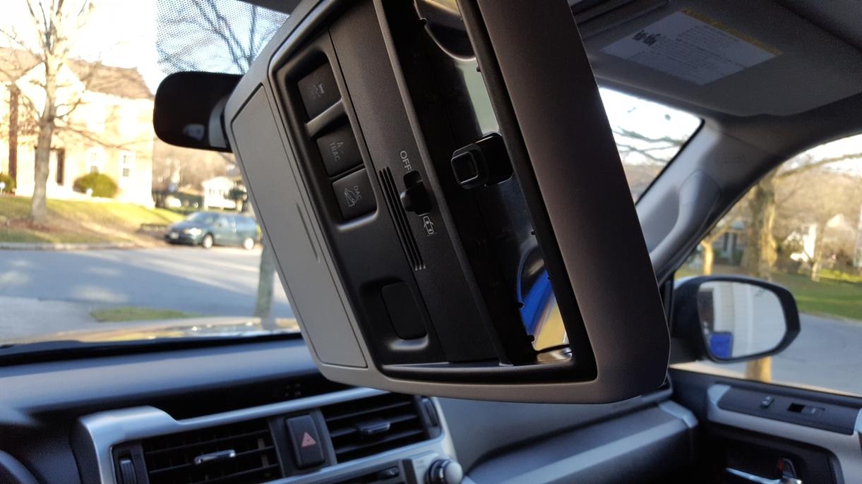

Replacing Map Bulbs
So big thanks to 2016 4Runner SR5, I was able to remove the overhead console to get the map bulbs out.
[Is that the best way to tag someone..?]
1. Open sunglass holder
2. Unscrew two screws there.
3. Gently but firmly, pull down on the overhead console - there are two clips that hold it in from the back.
4. The map bulb housings twist a quarter of a turn and pop out.
5. Pull old bulbs out, replace with new.
Not a big deal for most but good for me. Slowly gaining competency around doing little stuff like this.
