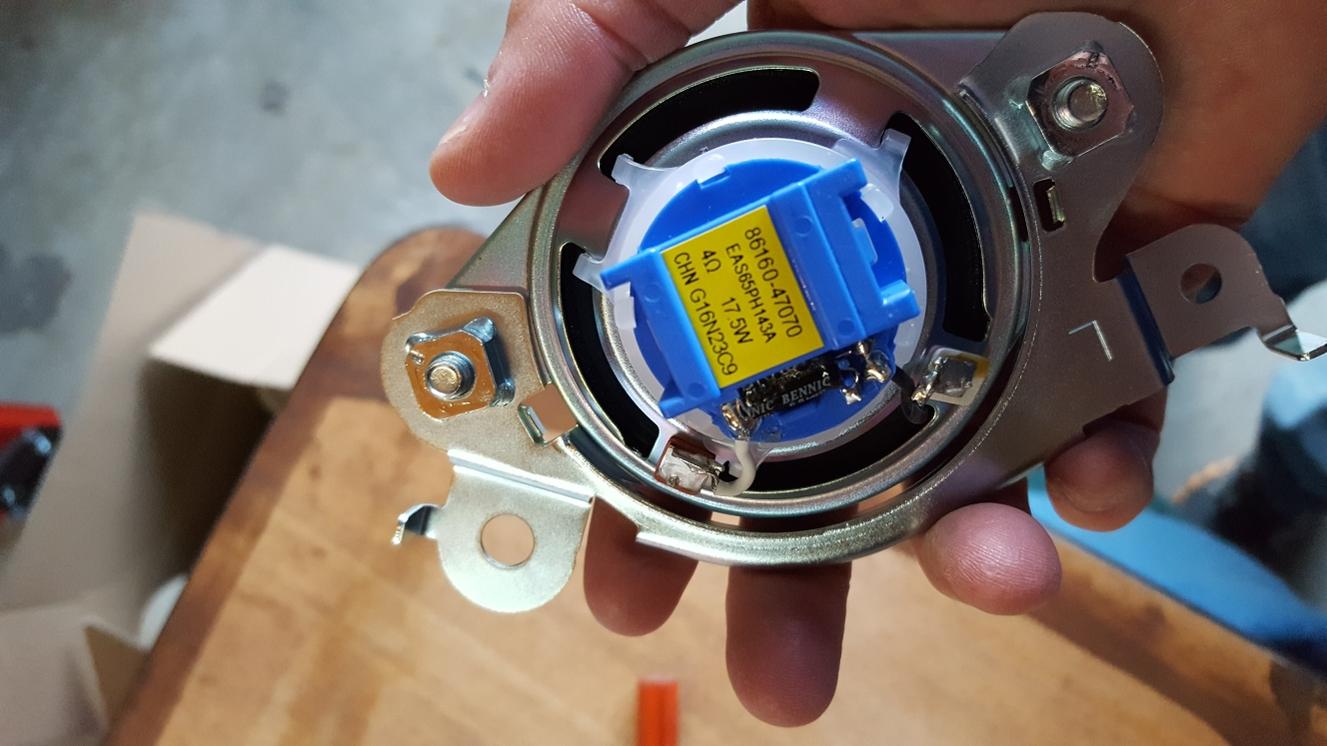

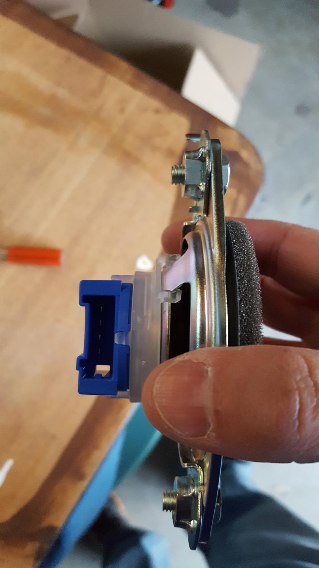

Here are my specific steps, pictures may help.

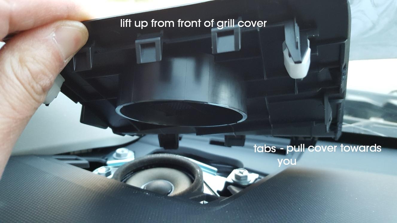

1 - Remove speaker grills. Using a dashboard tool, pop the side closest to you - there are 3 tabs across that edge. You can then pull the grill to you as the backside has tabs that fit closer to the windshield.

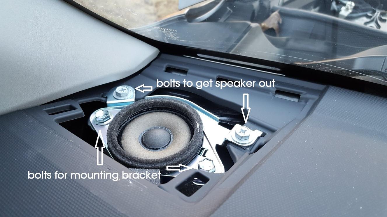

2 - You'll see 4 bolts on the speakers. Two are to remove them from the dash. The other two are to remove the mounting bracket - loosen those two as well which will make getting the mounting bracket off easier. Remove speaker.

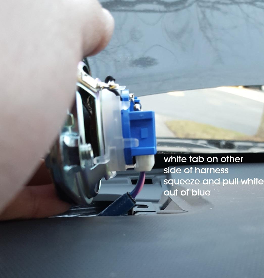

3 - Squeeze a tab on the white half of the wiring harness and pull this out of the blue harness. Now your stock speaker should be totally unattached from the truck.
4 - Carefully remove the blue stock harness from the backside of the stock speaker. This is just glue on the backside - use a small screwdriver. Either cut or desolder the stock speaker's connections to the stock harness.

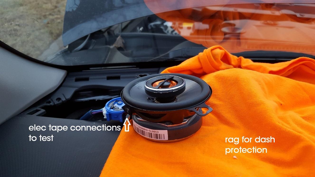

5 - Connect the new speakers to the stock harness temporarily using electrical tape. Reconnect the harness back in the truck and test to make sure the speaker works. Get excited about better sound.
6 - Solder the connections you just made.

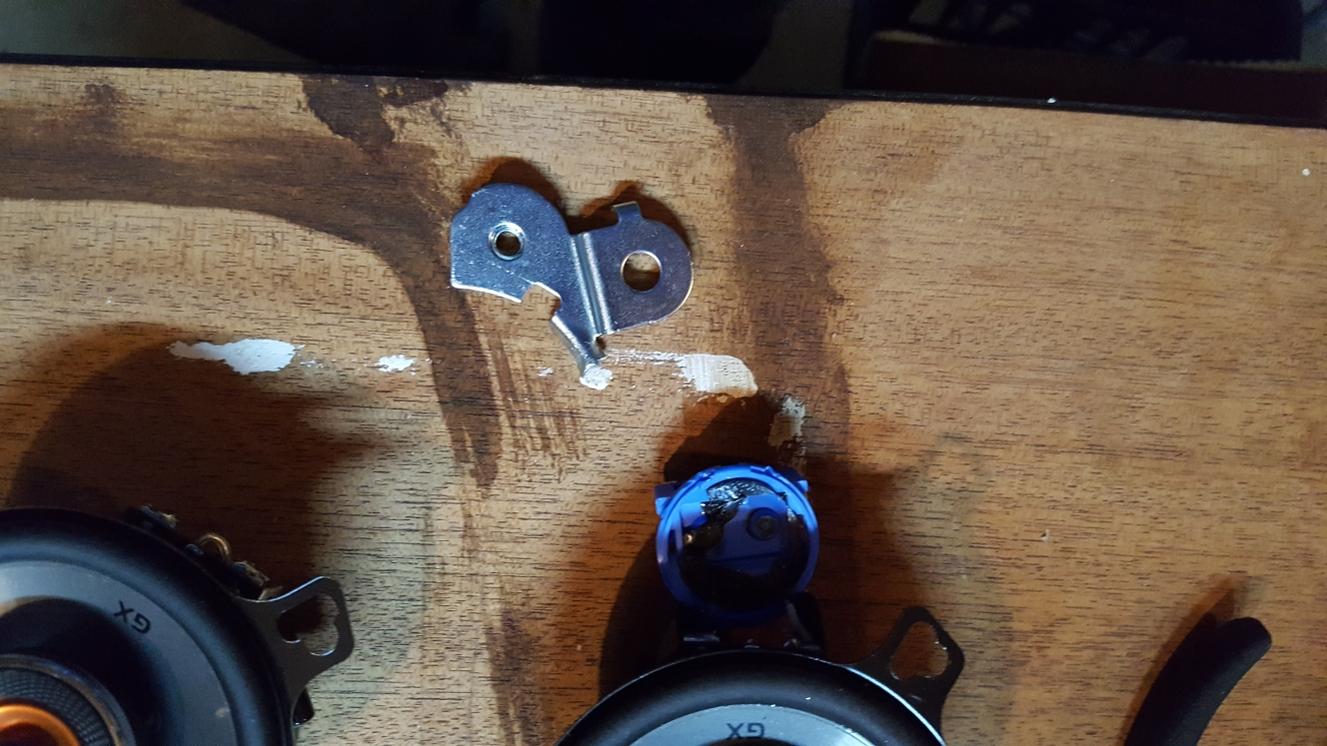

7 - Put the speaker back into the dash and screw in one of the fastening bolts - I think I used the right side ones. You can then see how much you need for a replacement bracket on the other side of the speaker. Most likely, it will be just a small piece of the original mounting bracket.
8 - I used a jigsaw to cut a small notch in the stock mounting bracket where it was needed. After the notch was cut, I could use some pliers and bend the bracket to the point where the piece would break off.
9 - Put the speaker back into the dash. Connect the harness. Fasten the speaker using the modified bracket and the screws.
10 - Do the other speaker just like this one. Crank it up.

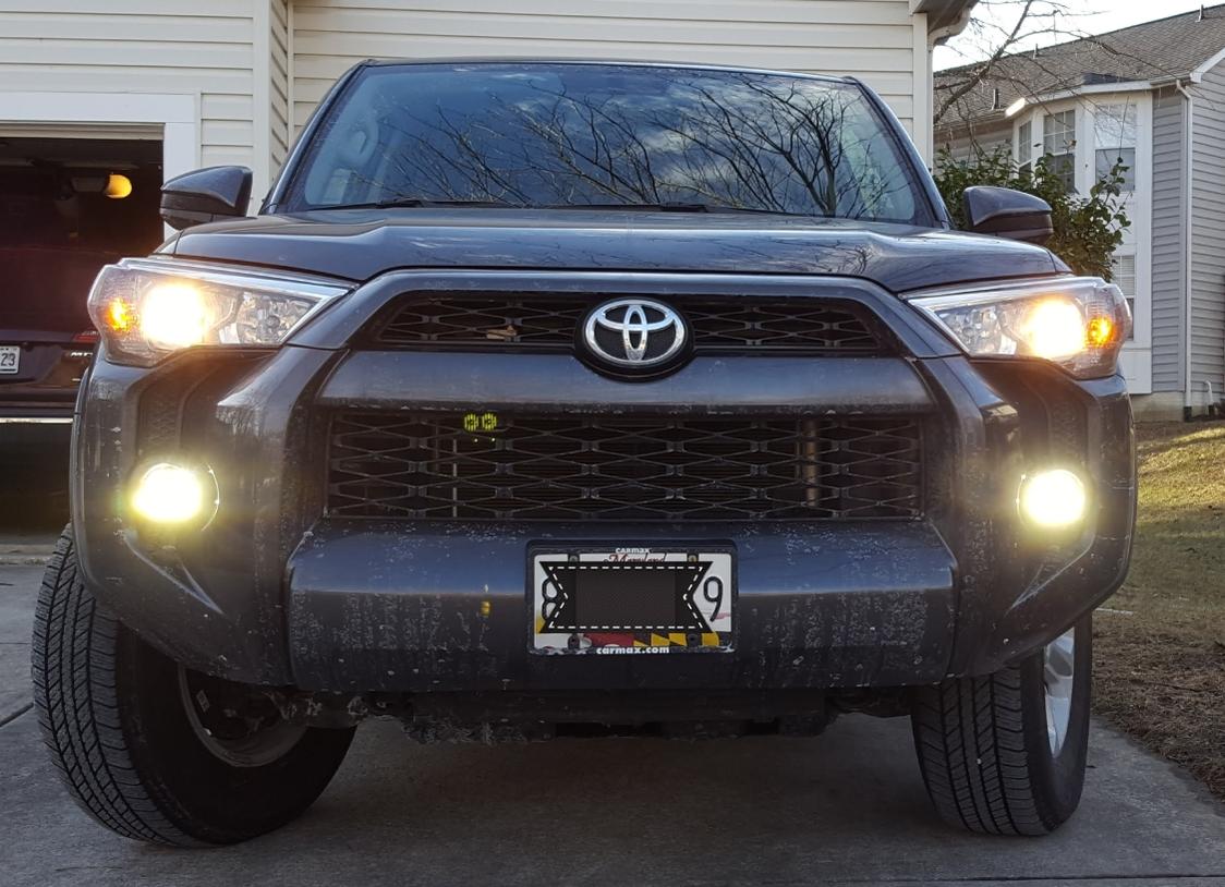

Baja Designs Squadron Sport - Fog Light Replacement
I replaced my stock fog lights with the Baja Designs Squadron Sport lights today. Pretty straightforward overall. The main guide I used is here. Here are a few of my personal notes.
1 - I somehow lost one of the stock screws for the lights, which you reuse when putting in the new BD lights. Figures. Got a replacement at Home Depot - they are #10x 1/2 inch - perfect fit.
2 - The driver's side is pretty straightforward. The passenger side is tougher because there is a splash guard over the light. I was able to pop off the left side but eventually had to use some snips to cut the right side off.
3 - On the passenger side, also remove the outer splash guard by removing a few of the bolts on the bumper and underneath. Also turn your wheel all the way to the right. Both of these will allow you to bend the splash guard to get enough room to work your arm up in there.
4 - There are little tabs that one side of the lights fit into. The other side is where you screw them in.
5 - Make sure to buy the pocket kit too. This includes the right brackets and wiring harnesses.
These are super bright - like them a lot. Simple mod that wasn't too bad and remember I'm no mechanic and got it done. Work nice and slow and take your time.

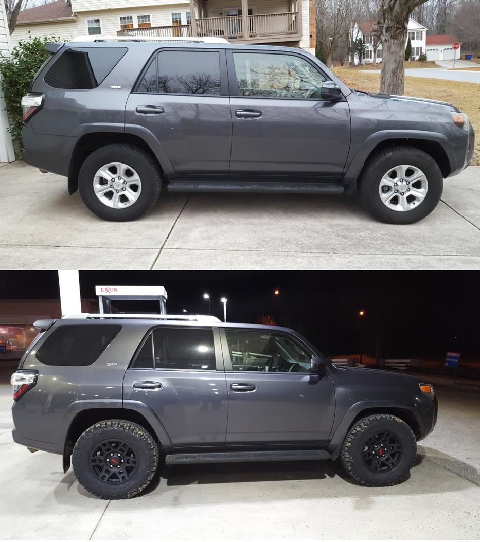

Before and After - Wheels and Tires
TRD Wheels. BFG KO2 - 275/70R17. No rubbing so far.
