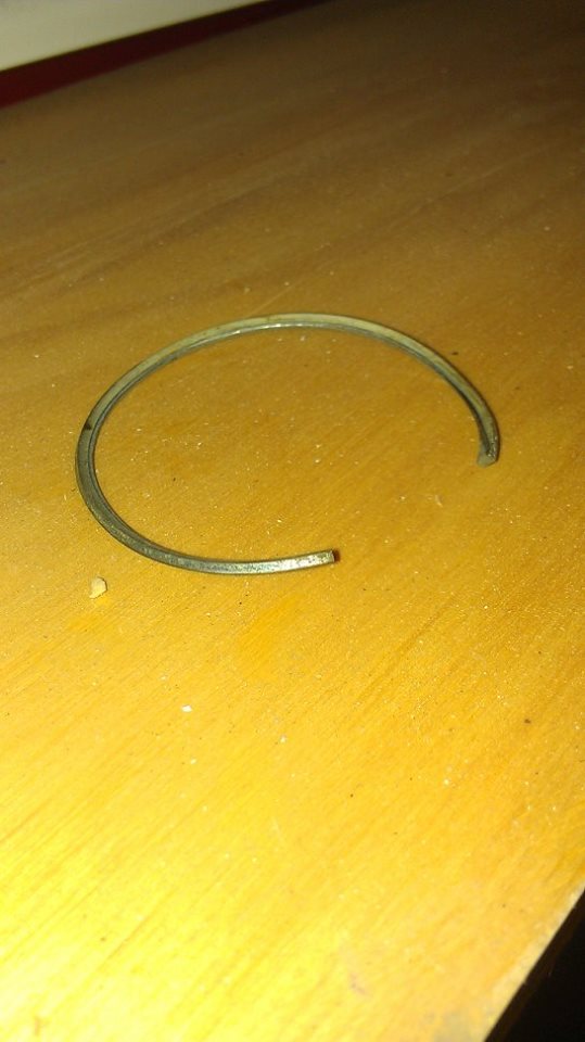

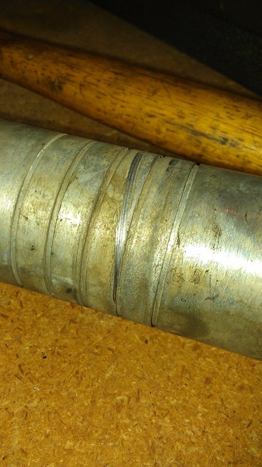

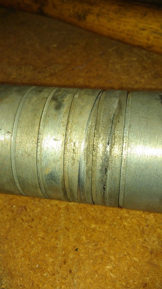

i had mine almost fail... drivers side tundra 5100
now while i think that sure the added weight i have might have been a partial factor in this, lets take a look ad a few other things here;
1. the tundra weighs more
2. if the strut was never designed to be ran at the top two settings, why did bilstien build them with that capability?
3. installing a c-clip is not rocket science...
now i didnt ask for my 5100s to be on the 4th setting, i said 3rd setting to the tech that adjusted them, so maybe he is a idiot and cant properly install a c-clip idk, but as you can see i was barley hanging on... that could have been a nasty failure and cause a nasty crash possibly even deadly crash...

kid, how was the perch oriented?
was it sitting correctly, or upside down?
if it was correct, i dont see how its possible for the clip to come out, since its being contained by the perch.
i know how to instal coil perches, and what to look for, if the shop had put them in wrong i would have noticed. they were installed correctly
If the seat is on correct and the clip is fully in the grove, the seat snugly encases the ring. I would say installer error, I have installed hundreds with no issues

Well i guess that i can now say i've head on a C clip failing without the perch installed upside down :lol:
Even though the perch wasn't upside down, i bet the C clip either wasn't fully seated or the shop stretched it out when trying to move it.
As for point #2, The shock is fine to be run on the top clip setting. BUT, that only applies when the shock is installed on a Tundra with a OEM Tundra coil. Installing it on a 4Runner with a Tundra or a Toytec coil isn't the same thing and its going to give it too much lift.
