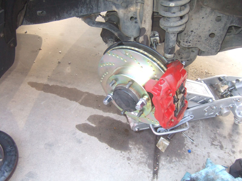

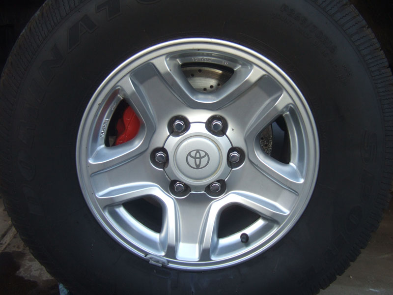

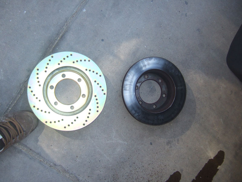

my old 97
I had done the 199 upgrade on my old 4runner. i remember it being WAYYYY better than stock. it has been 8 years since i did it though.. plan on doing it to the new 4runner as well. these were NAPA calipers and ebay rotors. unsure about pads. probably ebay pads that came with the rotors.
