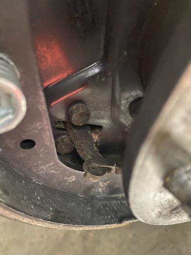

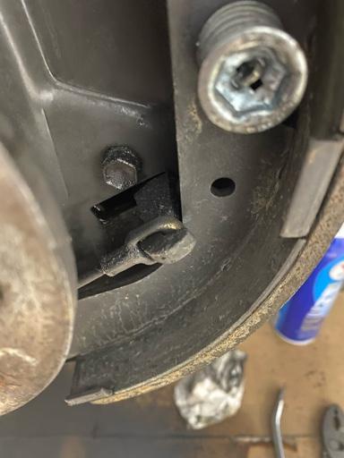

Swapped drums and had the same problem. Did notice that when the ebrake is pulled, the hot side bell crank lever extends all the way, but the cold side doesn’t. They’re not frozen or anything, I packed them with grease during the refresh.
Hot side ebrake pulled
Cold side ebrake pulled
Thoughts?
Thoughts?
Do you have any photos of the brake shoes right by the bell crank lever? I had a problem with the grease from my bell cranks dripping onto the drum/shoe once the brakes heated up enough.
No pics, but the shoes were dry.
I saw your other post where you swapped drums side to side and the vibration followed the drum. That tells me that the original side the drum was on (left side if I remember correctly) has a problem with getting too hot. I would bet that the adjuster is over adjusting. This could be due to a faulty adjuster assembly or incorrect setup. Have you compared the drum brake setup on both sides to see if there is any difference in setup. They should be mirror images of each other.
