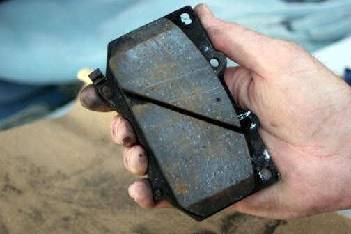

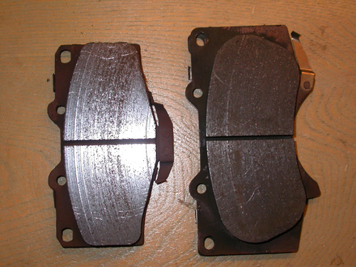

I was curious, so I looked this up...
STOCK pad on the left VS. 231 pad on the right
199 pad
It looks like the stock pad and the 199 pad have about the same contact area with the 199 pad having a slight bit more at the corners on the hub side of the pad. They appear to me to share the same sized backing plate. The 199/231mm rating speaks to the size of the pad opening on the caliper. I will bet that the stock calipers also have a 199mm pad opening, the only difference on the Tundra 199's being that the opening is slightly wider to accommodate the thicker rotor.
The 231 pad is slightly larger again than the 199 pad, but notice the big jump in the size of the backing plate? That is a major factor in heat dissipation from the pad into the caliper. Then you have the fact that the 231 caliper has a larger fluid volume, which also helps shed heat faster than the 199 setup.
