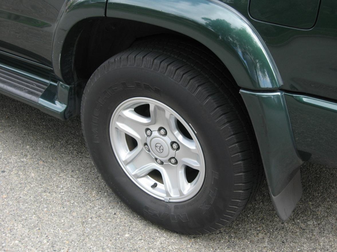

After replacing my rotors last year to eliminate brake pulsation, the problem is back again. This time, I've decided to simply do the "Tundra brake upgrade" which hopefully should eliminate this problem once and for all. My questions are:
1. Should I go with the 199mm or 231mm calibers? I'd like get the larger one if I know I won't have any interference with the brake shield of wheel. My 2000 4Runner is running the stock 16inch 5 spoke wheels.

You should get the 231 mm calipers as they will fit your rims fine. I dont know the part number, but the calipers will have 13wl stamped on them.
Hey, if you're gonna spend the money, might as well pitch in the extra bucks and go for the 231. Worth it, IMO. You won't have any problem fitting in those wheels, but you will have to trim the brake dust shield on the back side of the rotor regardless.

Thanks you guys! So it looks like the 2006 Tundra 231mm caliber and brake parts are the ones to get.
What exactly do I do with the brake shield? Sorry I don't know what it means to trim the brake shield.
