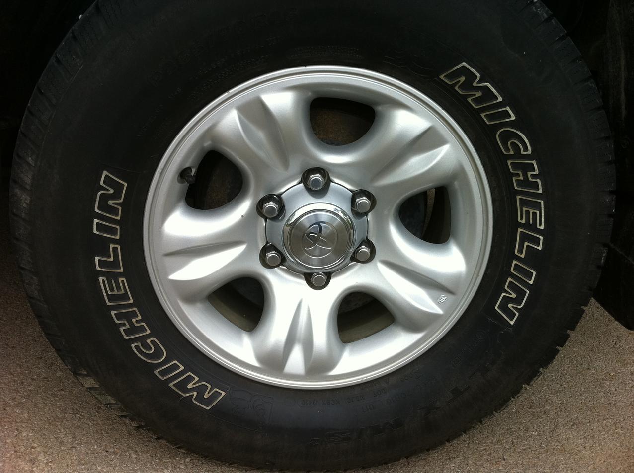

Will 199 or 231 fit on these.. They are stock 2001 limited wheels.

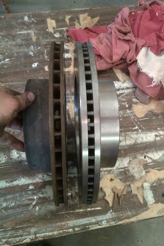

did you look at the two rotor side by side... there is a massive difference in the thickness of the two the tundra rotors are much thicker thats why we do this upgrade!
Oh yes I know the Tundra rotors are thicker. I just don't know why with the stock rotors, even after replacing them, I would have brake pulsation so soon. With other cars I've owned, I've never had brake pulsation. It was only when my 4Runner now did I have this and have to replace rotors. So it makes me curious why with brand new stock rotors, I would get brake pulsation. Are the stock rotors just too small for the weight of the 4Runner?
Becuase the stock rotors were designed for the tacoma, which weighs less. With a 4runner, the brake rotors have to soak up more heat on each stop than a tacoma would. Becuase these rotors are so thin, they cannot dissipate that extra heat well enough and get too hot and become warped.
