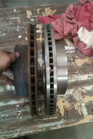

did you look at the two rotor side by side... there is a massive difference in the thickness of the two the tundra rotors are much thicker thats why we do this upgrade!
The additional mass/weight of the Tundra rotors adds means there will be far less heat related issues which are thought to be the main cause of the stock sized 4Runner rotors warp leading to vibrations. Warping is actaully pretty difficult to do in my opinion. Improper bedding, pad material, quality of rotors plays a significant factor as well. Sometimes vibrations come from non-uniform pad deposits and a simple bed in procedure or more aggressive pads will cure it.
Becuase the stock rotors were designed for the tacoma, which weighs less. With a 4runner, the brake rotors have to soak up more heat on each stop than a tacoma would. Becuase these rotors are so thin, they cannot dissipate that extra heat well enough and get too hot and become warped.
4runners should have had tundra rotors from the start.
Or, if we want to stir up an old debate, it's brake pad deposition at high temps, not warping. But the end result w. Tundra rotors is the same. (Edit: binhsterbinh and I are on the same thought.)
