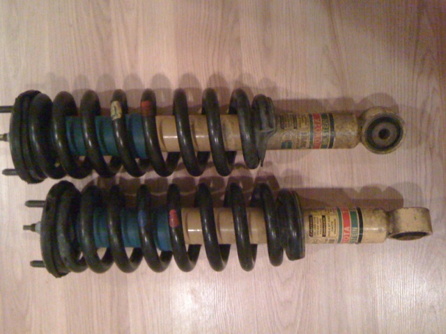

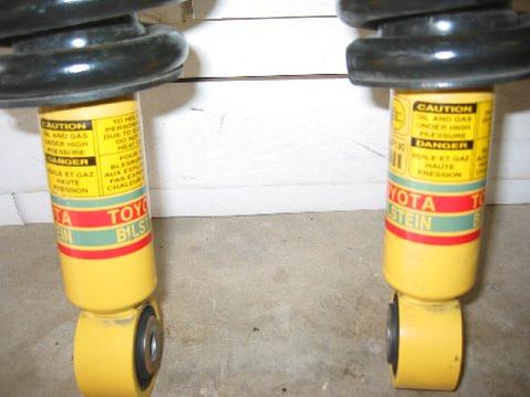

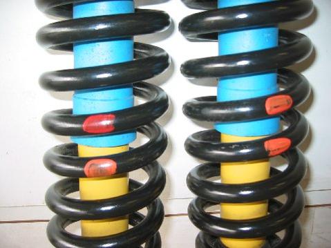

I know this has been covered a million times but I need some help! About to pull the trigger on some TRD springs to lift my runner. I know everyone says to go with the 4wd TRD springs with the yellow/yellow and blue/yellow color code, but was wondering about 2wd TRD coils. May be able to get these springs for $200 and was wondering what type of lift to expect. Any ideas?

Id say just go with the 4wd ones..The google message just goes away after you refresh the page..It wasnt on the pics when I looked at em..

Make sure that you get the color code (paint dots on the coils), Tundra TRD Coils. Left, 48131-AF100 (Yellow/Yellow). Right, 48131-AF090 (Blue/Yellow)

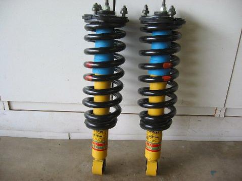

Instead of starting a new thread, I'll try to revive this one. Anybody try using (or know the repercussions of using) the Tundra from an '06 Tundra TRD 4x4?

Most likely a Double Cab. I have read that they might be too stiff because they are made to accomodate the extra weight of the double cabs.
