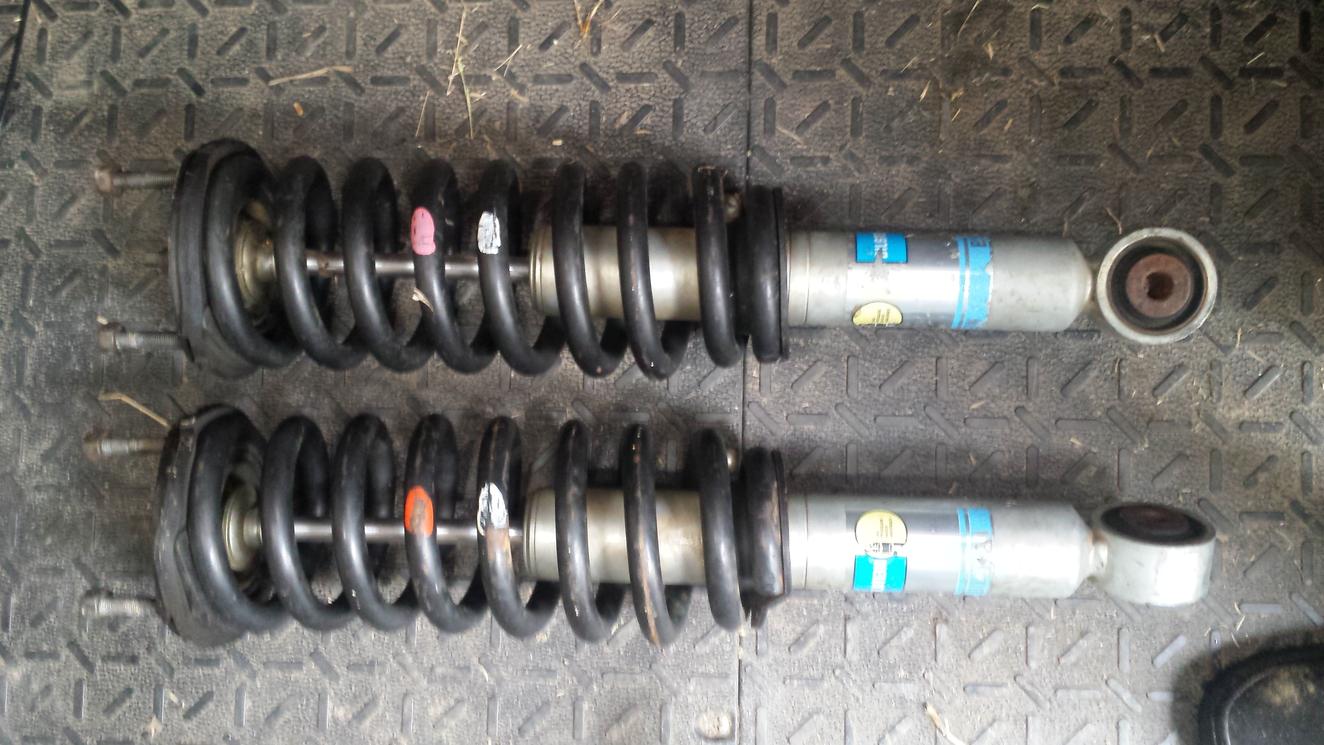

hey guys...bumping this thread cause it looks like it will here. i need help identifying my shocks, i been searching but cant seem to find anyone else that have came across these set...
the part number on the shock is f4-BE5-6929-HO which are the correct tundra shock. but the color code on the coils are orange and white, and pink and white.
can someone tell me if these will work, i would to slap them on asap...
Here they are

that is what i was afraid of. but the thing is, i havent seen anyone who ran into these coils so i don know what they came off of..
where is the cheapiest place i can purchase just the coils?
Classifieds. Try reference the Color codes with your local Toyota. The whole set up will work providing you change the top hats to Tacoma/4runner, but the height of the lift is questionable.

If no one has ran across them in your searches then this says you may be the first. Only way to tell is throw them in and see where it sits you. From my searching people that have installed other color combos never get the lift results they want.
It was very hard for me to find them a long time ago so I went with OME 881's, ome sport comfort shocks and 1" lift sleeves. I got 3" lift and no more searching for used parts I could not find. But if you keep trying you will find them.
My backup vehicle is harley and with this weather I don't have room for trial and error. I like to go with wats proven and just slap them in and be happy. Thanks for thee feedback guys it's much appreciated
