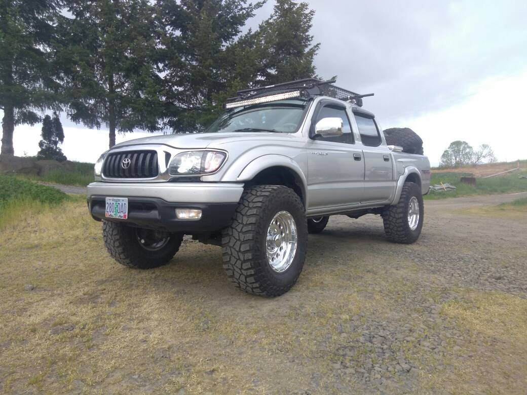

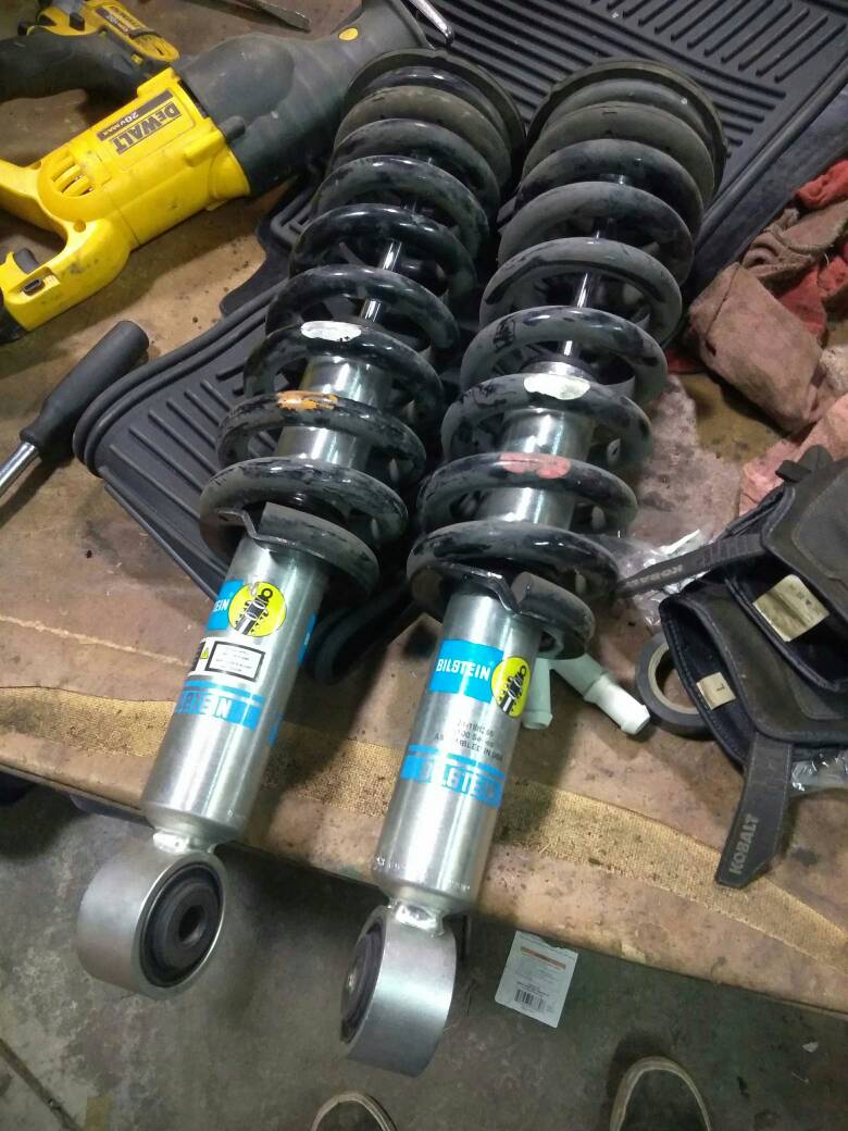

For anyone looking for a more readily available coil than the Tundra coils, I am running 2007 Tacoma TRD Double Cab Short Bed springs on Tundra Bilstein 5100's on my Tacoma.
Rides great, soaks up the bumps just as well as the YY/YB's I ran on the 4Runner. Mine are set on perch #2 and netted 2.25"ish of lift on my Tacoma with no extra weight. 3rd perch should be right around 3" on a 3rd gen with no weight.
This is a great alternative because I can get on Craigslist and 9 times out of 10 find a set of these coils for 100$ or less.
