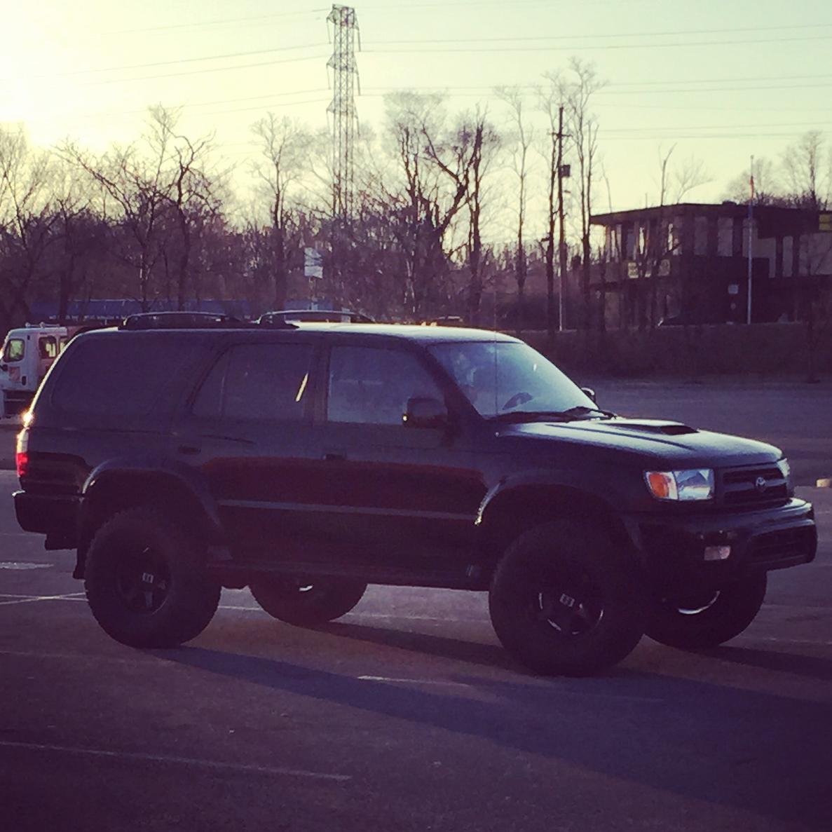

I just went with the TRD springs/Bilstein 5100 on 2nd perch up front, and OME 890/5100 Bilstein in back. On 285/75R16 General Grabber AT2 and 16x8 0 offset Level 8 MK6 wheels. No rubbing on UCA, just needed to trim a little on the running board end caps and the front bumper a tad. Ended up awith about 2.5 inches up front and 3 in the rear. Rides a lot better thus far.
