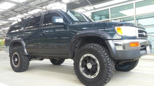

Got my Billies, tundra coils and OME 906 coils in. Only drove it for 15 miles but can already tell the ride improvement. Up next, wheels and tires.
What a difference tires (265/75 Duratracs) and rims (Ion Alloy) make! With the settings on first perch and 906s in the rear, there was slight rubbing on the front right fender flare when I make left turns. Shaved the corner off (front inner side of fender flare) with the dremel (less than 1/4 inch removed) and no rub now.
