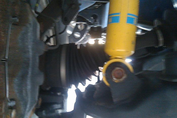

How are your cv's. Do you really need the diff drop with the tundra coils.
They're not bad. They haven't torn yet, but I will be putting the diff drop on. It's not absolutely necessary, but it does help. It also depends on how high you want to go. For just the coils and no spacers it won't be necessary, but typically adding a spacer it is recommended.
CV Angle
Here is a pic of my CV angle with the toytec eibach 3" heavy springs and Bilstein 5150 HD shocks. You can get longer boots so that you don't worry about tearring them. I don't have those currently. Also, I don't have a diff drop.

im wantin to do 3 inch all the way around with best ride it is still dd
Tundra coils will not give you 3" of lift unless you use adjustable perch 5100s. The TRDs do ride nice. When I had mine, my rig was (and still is) a daily driver. I did and do drive cross country and it rides and handles great.
