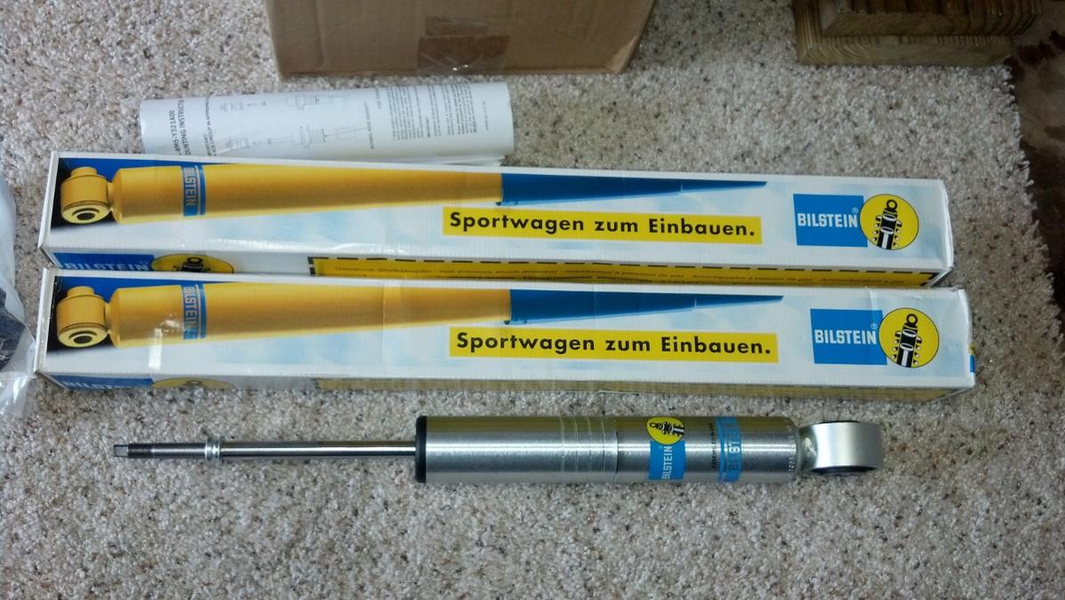

i need something to go with these!

Either use your stock coils, some 881s, or some eibach coils from Toytec. Any of these can get you 2" of lift with those 5100s.
ok. what position should i put the perch on for each choice so i get level or slight rake, back to front, as i don't want to use spacers?

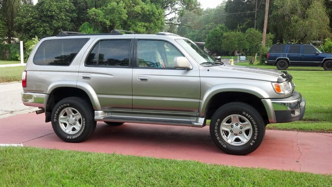

i finished installing the billies today and since i haven't found and tun coils, used my stock coils set on the 4th groove. i was at 34" from ground to bottom of flare. although it looks much higher, it is 35.25 front, 36.25-36.5 rear. when i find tundras, i'll just swap.

^^^ Looks pretty good for your stock springs, what are you running out back?
906's/billies. i noticed today that the front has sagged a bit and now i have more rake. i already got it aligned so if i raise the spring to the 5th groove, the alignment will be off.
I think it looks pretty good IMO, I can't imagine they sagged too much
