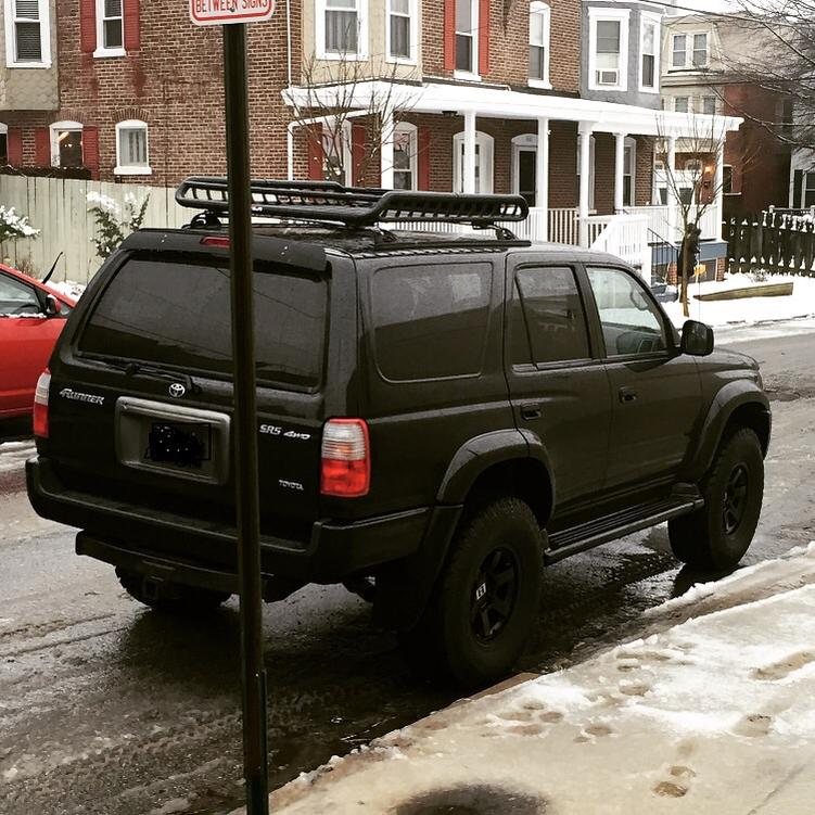

Just wanted to show the final product of my recently installed Tundra TRD coils/OME 890 with Bilstein shocks all around. Front adjustables are on 2nd perch, and the ride is GREAT this far. Tires are 285/75R16 General Grabber AT 2 with 16X8 Level 8 MK6 wheels in black. Got about 2.5-3 inches and only rubbing came from the end cap of the running board, loving the new look!
