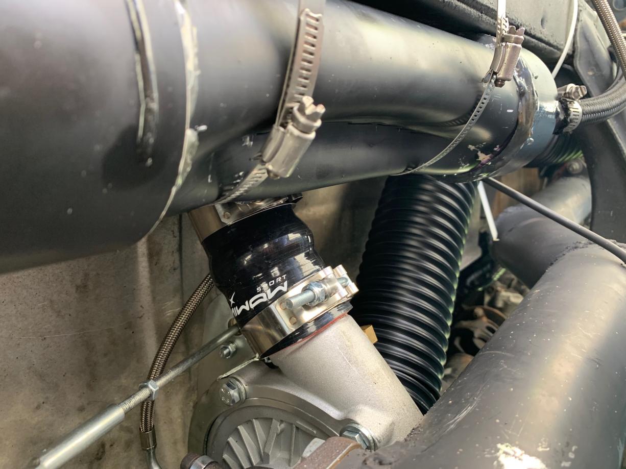

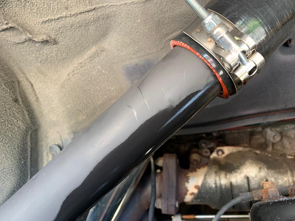

Looks like the cheap pipe clamps that came with one of my fittings came off, causing a boost leak, which would explain the lack of boost and weird symptoms. Running good now! Need to do a boost leak test at some point, apparently that can explain why there is lag in it generating boost (since I was expecting it to start generating boost around 1500-2000 in lieu of 3k).
It’s running and producing boost though, so I think I’m going to lick my financial wounds (spent closer to 1300 total in lieu of the expected 800) and enjoy it for a little while.
I ended up just running flexipipe for the intake back to the turbo, now that I see how it all runs, I’ll probably slowly replace it all with silicone fittings and actual piping.

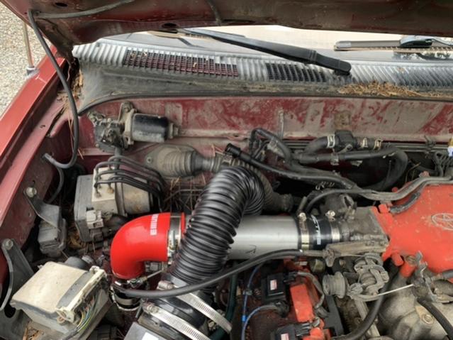

Few updates after a week or so of driving it around.
I tightened up all my t-bolt clamps (except one, which I broke), boost seems to be coming on much earlier/stronger. Can't wait to get the new one in tomorrow and see how it reacts with no leaks.

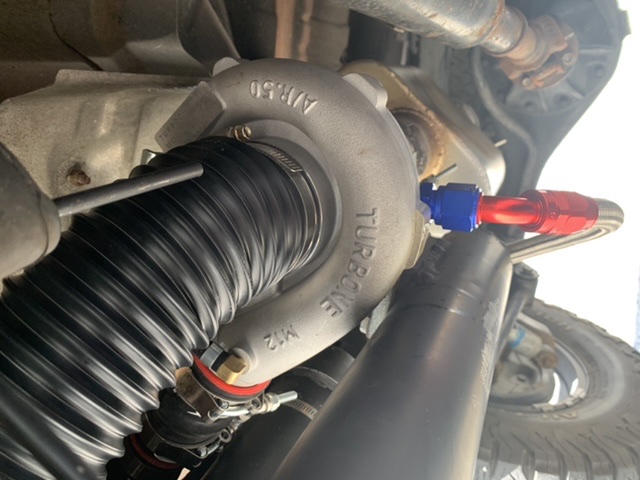

I did some research before installing my oil lines on the turbo to determine if i should use a restictor in line. All the turbo experts/manufactures recommend for a journal bearing turbo to use no restrictor, but most people say they use one. I opted for the experts opinion, but im getting an awful lot of oil in my charge line. I'm gonna look around for one that's the right size to put in line.
My sump seems to be working good for letting the turbo drain out when I shut it down, as i've been seeing no smoke on start up or anything, but i mounted it on the inside of the frame rail and its not been able to stand up to the heat.

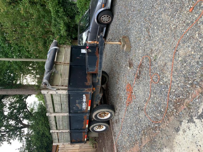

Went and picked this up from my folks place tonight, which is ~30 minute away down the highway. I used to struggle when it on the highway, i'd have to stay in 4th just to keep up with folks at highway speeds. I was now able to comfortably cruise in 5th. Boost jump anywhere from 0 to 3psi while i was pulling it home. Overall very happy with how much better it pulled.
So about 5 minutes out from my house I started billowing smoke real real heavy out of the tail pipe (see video below). Got pulled over and noticed that my scavenge pump wasn't working. I guess it has a thermal overload on it that shuts it down if it gets too hot. Currently my pump is also mounted on the side of the frame rail next to the exhaust. So im planning to mount it and a new sump on the outside of the frame rail in order to help sheild it from any heat. This will also simplify my intake routing since there won't be anything between the exhaust and frame rail to dodge.

Moved the pump to the outboard side of the frame rail and made the reverse trip of the week before and it ran just fine, no issues.
Found a 0.075 oil restricter that’s a 4an male to female (biggest I could find when searching for restricters). Installed it this morning. Hopefully it’ll cut down on the amount of oil in my intake. It was starting to cause the truck to idle high from oil coating the throttle body.
