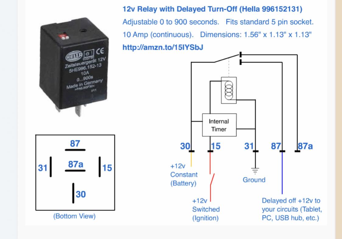

My DIY sump is about to go (as in, I’m annoyed with it), I’ve noticed if I don’t leave the key in ACC for 20-30 seconds after turning the car off, I get more smoke on start up. So I bought a delay-off relay that I’m going to wire to the scavenge pump and a check valve that I’ll put at the pump exit. Relay comes in this weekend, hopefully I’ll get it put in this weekend.
Delay-off relay
My delay-off relay is installed and seems to be working great. Right now it’s set to go off after about 30 seconds. Check valve hasn’t come in yet, but I’m excited about the relay.
I used this for wiring instructions.

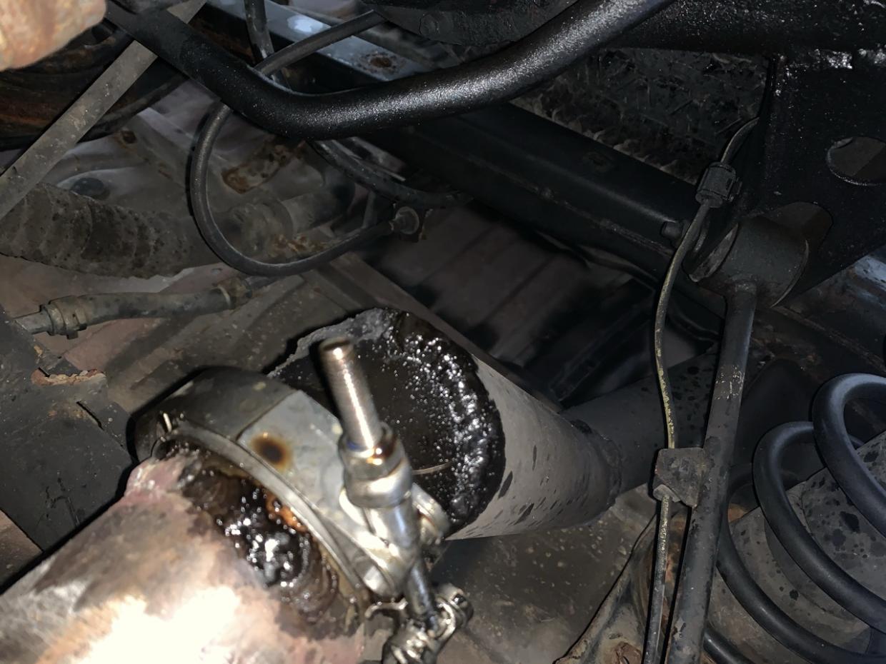

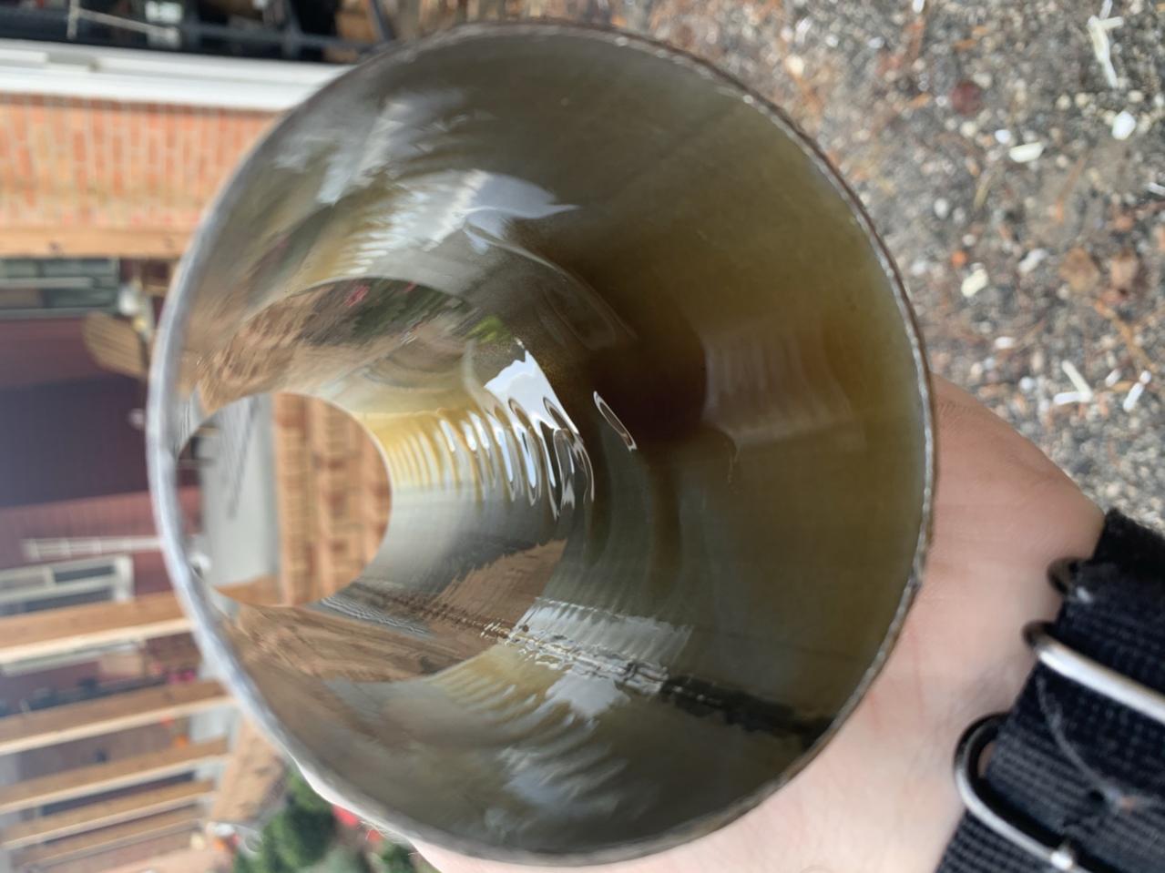

Check valve is in. I was able to reroute my oil return lines too since I’m no longer using the sump, looks much better under the vehicle. When I disconnected the return line coming out of the base of the turbo, I had ~12oz of oil come out, which would certainly explain why I’m still getting so much smoke out of the tail pipe. So hopefully all this makes a big difference.
First picture is the elbow right after my muffler, gives a little bit of an idea of how much oil has been getting pushed though (and how many pin holes in my weld joints).
Second picture is my intake pipe going into the throttle body. Hopefully these changes make a difference in that too.
