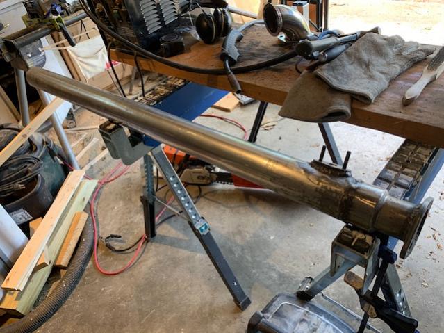

All of my exhaust parts finally came in. Managed to fab this up today. Decided to wait to put my elbow and flange on until I have the turbo and muffler to make sure im cutting the pipe at the right place for where I want everything placed under the vehicle.

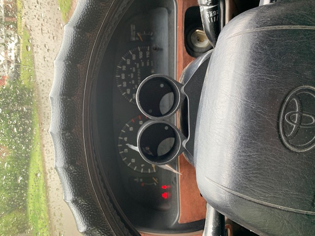

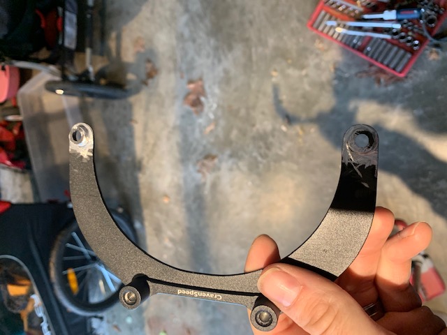

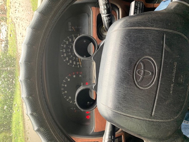

CravenSpeed Gauge mount came in. I'm happy with it, it looks sharp and good build quality. I did have some issues with the install. The boss on the mount that is supposed to interface with the steering wheel was ~1/16th too large. I contacted them and they were super quick to respond, great customer service. Ultimately they said they're not sure what the issue is, and they'd be happy to process a return if that's what I wanted. Just took the grinder to it and took it down a bit. Not sure which orientation i'll ultimately leave it in, close together or farther apart.
Also, can someone explain to me how to rotate my pictures so they're not sideways?! does it just have to do with the orientation that im taking the picture in?!
Edit: these show up in the correct orientation on my phone but not my laptop?!?

At first I thought you posted the same pic twice, then realized you adjusted the gauge pod placement :laugh:
What gauges are you getting? I don't think you mentioned it before.
I like the placement of those gauge pods over a a pillar mount. What all do they block though?
Looks like mostly various warning lights. I tried to make sure I took the picture from eye level to give a good reference as to what it’ll actually look like to drive. The mount was certainly more expensive, but I think I like it better.
