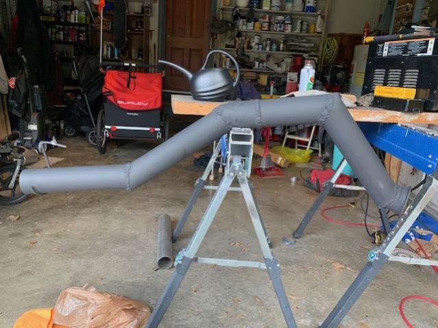

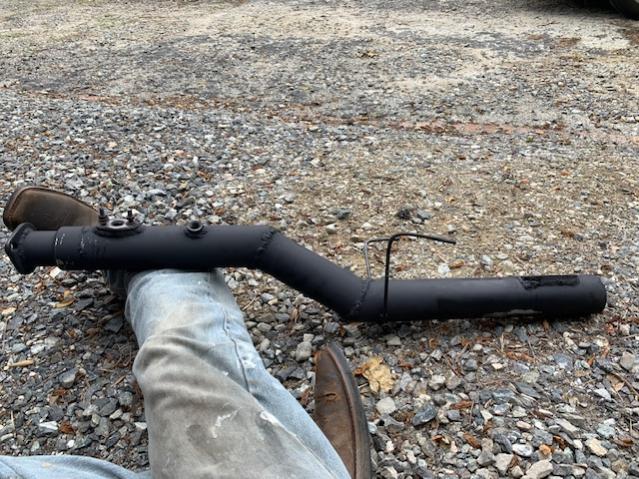

Finished building the exhaust this weekend (back to the turbo), which took significantly longer than expected. Because im planning to run a muffler, I need to place the turbo farther forward than others have done, so I ended up needing to put a bend in the pipe in order to provide more clearance between the pipe and the body. Overall i'm happy with how it turned out. I started working on building the rest of the exhaust from the turbo back, ended up running out of welding wire though.
Before anyone ask, yes im running the wideband pre-turbo. Instructions for it said after the turbo but before the cat...which I literally can't do. Given that im running a very low amount of boost in the grand scheme of people boosting vehicles, I don't think it'll be a huge issue. I also wasn't sure how on earth i'd be able to run it post turbo, although there might have been enough wire, it would be close for sure. I guess if I notice anything wonky once its all hooked up/im making boost i'll look in to moving it.

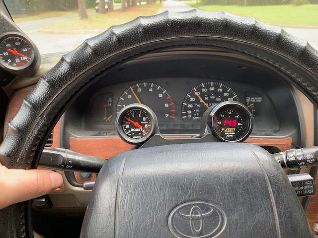

I also got my gauges installed today. I'm pleased with how they look and the quality of the CravenSpeed mount. I ended up needing to sand down the gauge though in order to get it to fit into the bracket, which was frustrating/time consuming. A lot of sand a little, try it out, sand a little more, try again. So all in all, the gauge mount looks great, and is very sturdy, but I had several issues with install that make me hesitant to recommend it to anyone.

Pre turbo placement is fine; they basically say not to because installing pre-turbo on a "normal" turbo vehicle would mean locating it at/by the header/manifold collector which would end up burning out the sensor.
Finished up the exhaust this weekend, probably would have been significantly easier/better looking if I had more than an angle grinder and harbor freight flux core machine, but, its done. The V-band clamp on the right side of the picture will mate up to a v-band I put on the muffler.

Idle AFR is pretty consistently 15.1
Cruising down the highway at 65-70 my AFR’s bounce between 14.9 and 15.3

That's what happens to mine when the O2 sensors are old or fouled. If you'd rather see it bounce between 14.4-15.0 replace the front O2 sensor.
Oh btw, once you richen up the tune you'll be buying front O2 sensors annually. Mine last between 6-12 months.

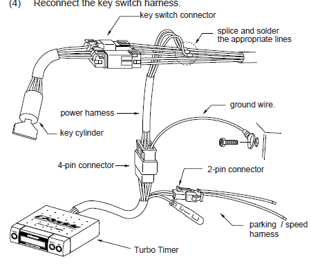

Might be in a position to get all the oiling stuff installed this weekend (got the bike and mr2 running good for now), and I want to get some other opinions on what I’m planning for the turbo timer. I emailed Greddy’s tech support, and their response was “we’ve never used it in an application like that, here’s a link to our manual”, so that was worthless.
It’s a Greddy Full Auto Timer, which has all sorts of functionality I’ll never use. Looking at the first picture I’m thinking it would be safe to assume I don’t need to be concerned with hooking up the parking/speed harness since I will never use it like Greddy intended (yet their tech couldn’t answer me if the unit will still function without those wires being connected).
Looking at the second picture, here is my thought process/assumptions.
12v -> red, should be to any 12v constant power, this is what will keep the pump running once the motor is off.
Blue -> ACC, should be anything that has power when the key is in the ACC position but not when the key is removed. My assumption here is that this is how the unit knows that you’ve turned the motor off and how to start the countdown timer to kill power to the pump.
Green -> to pump?
Black -> ground
Green -> to pump?
Black -> ground
I have zero experience with Greddy brand turbo timer, but a couple I have done definitely required the park/neutral wire to function. I assume it has a built in fail safe so you don't turn the key off in drive and it keep the engine running.
That should be easy enough to tap in to, should just be able to tap in to the switch for the e-brake (I assume).
Any reason for the speed one that you can see?
The ones I dealt with were only a park/neutral signal. Do they want a park/neutral signal AND a speed signal, or is it a one or the other kind of thing?
Good idea to keep the scavenge pump on for a while after the motor is off.
I like having the parking wire hooked up. You'll probably want to set it to 30s or something and that's it. But you can always release and reset the parking brake to turn off the pump. You can leave the speedo connection open/disconnected with no problem - if connected it can display your speed digitally if you want...
I think you are going to want to use a relay to power the pump, with the coil triggered by both the ignition power and turbo timer output, but diode isolated.
I can't remember what triggers the turbo timer to start its countdown. I know for sure that my old-school HKS turbo timer starts its countdown even when I just switch to ACC mode.
You are probably going to want to do this process in stages. You know you need to hook up constant power, ground, etc. From there, you can experiment what it does with power applied to various wires...
-Charlie
It has two wires. When I was reading through the manual for it, you can apparently set it to alarm if you’re above certain speeds and stuff
-Charlie
It would make sense for it to use the ACC as a trigger. I’m assuming that I can hook that wire up to anything that doesn’t have constant power but does when the key is in ACC (I.e. cigarette lighter).
I’m think you’re probably right, just hoping to narrow down the amount of experimenting/frustration of connecting and disconnecting wires.
