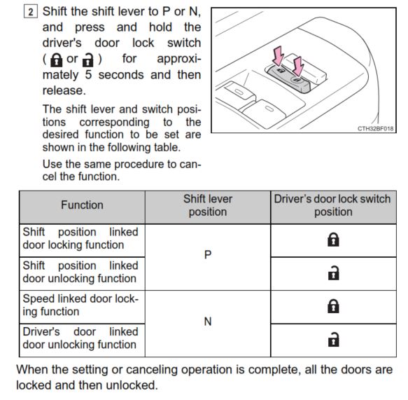

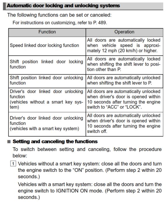

Yeah, mine too. I played around with it a bit, but still don't have it behaving the way I want it to (I want speed linked lock and driver's door linked unlock). I think it will work, but I just need to spend more time messing with it.

Wow, I did see that page in the manual but it wasn't clear to me at all what the outcome was supposed to be! I guess the short version for those who want to turn off the auto-lock would be "while parked, turn key to ON, press Lock button for five seconds, let go"
I want my doors to lock when I shift out of park, but stay locked when I shift back into park. I found the instructions in my 2017 manual and have tried them numerous times, but nothing changes. What is the secret?
