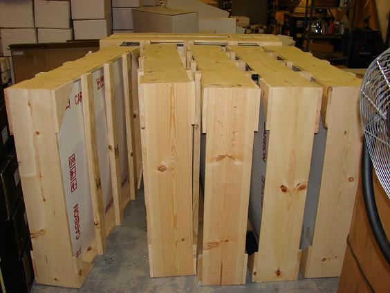

1) Wood Crate or Palletized Box
It seems from many car forum searches that successful shipping without any damage depends highly on having a rigid, wooden or palletized crate or box inside of a cardboard box. A cardboard box by itself with just foam and bubble wrap inside has a 100% damage rate no matter how much foam and protective cushion goes in.

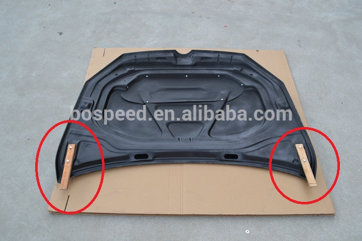

3) Bolt on plywood pieces in the corners (nearest windshield at the hinge mounts)
Having a piece of plywood bolted on in each corner that extends beyond the outer edge (I'd say by about an inch) of the hood corner will keep the corners from folding or bending during shipping. I've attached a photo for reference. The corners should be extra padded in addition to this.

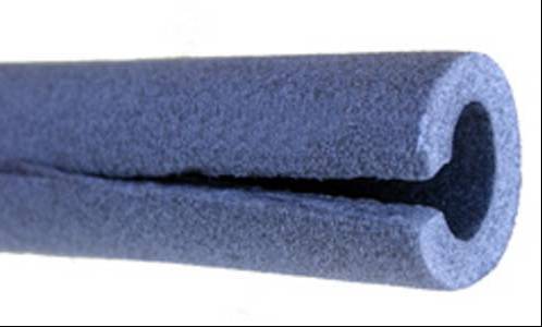

3) Cover every edge with pipe foam (photo attached)
Every inch of the hood's edges should be protected with pipe foam that's secured with a tape that won't cause paint damage - 3M or blue painters tape should do the trick. Do NOT use duct tape or electrical tape. It's best if the pipe foam is applied after the hood is shrink wrapped so when the pipe foam is taped down to the hood, the tape adhesive won't touch the paint on the hood directly. Pipe foam is available at Home Depot, Lowe's, etc. Kids swimming pool foam floater tubes may also work really well and may possibly be cheaper.

Thanks for your very informative post. I especially like your idea about the foam piping and the wood slats bolted on the underside extending past the points.

As far as bolting on the two slats we will have to figure that out. There is one large hole towards the point end that could be used with perhaps a rectangular style bolt that fits in the hole. The other hole that could be used is very small, so I'm not sure what to do there.

I bought four of these and went back to get a fifth. When a slit is cut down the length of the tubes they grip on the edges of the hood like a pit bull!
Protecting%20Hood%20025.jpg~original
The tubes along the windshield edge and the grille edge did not even need to be cut.
