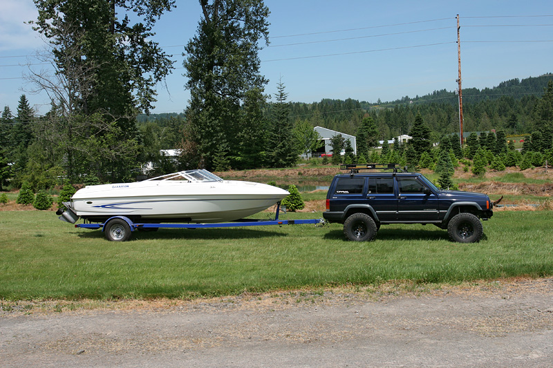

To give a little history on my vehicular hobbies, I've owned import cars (Civics, SI's, Type R's, etc.), a couple full size trucks, a pretty custom lowered astro van, still own a body dropped and bagged minitruck that is totally shaved, and the most similar vehicle was a decently built Jeep Cherokee XJ. I loved that XJ. I bought it bone stock with the goal of never putting it on a trailer while being able to go anywhere I wanted to. I succeeded but also learned that it was not easy or cheap. I ended up with about 6"of lift, 4.56 gears, lockers on both ends, mild armor, and drove it almost 20k miles a year.
