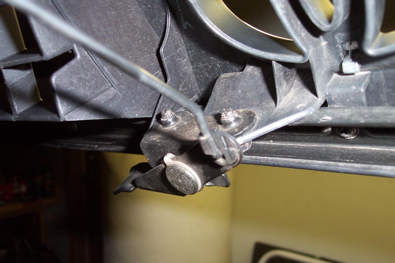

I am attatching pictures in another reply
I went to Home Depot to look for a 10mm nut, but then when I found them, I realized it would be too big. The screws/bolts are still in there, I'm just missing the nuts... so you think 6mm?
A Picture to Clarify
This is a good picture. It shows the bolts through the plate and threaded into the latch mechanism. As long as nothing is missing except the bolts, then (2) M6 X 10mm should do the trick. Even M6 bX 20 would fit, you would have extra sticking out but no big deal.

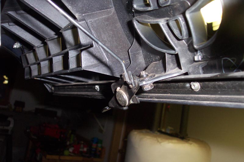

Another one not as good
Here's another picture, shows both threaded bolts through into the latch plate but not the hex bolt heads. Try for stainless steel bolts if possible. Zinc plated is ok but they will eventually rust, might take many year though.

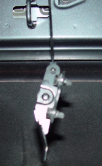

at home depot, i went out to my truck to grab one of the bolts so i could take it in to fit something to it, but it turns out you can't pull the bolts out from the latch part ... it's weird. i can't explain.

i see why you are confused ... ours fit differently. see the part hanging here with the bolts through it? that part has been sitting BELOW the part which is actually attached to the grill. so it's BELOW the part that yours is above ...
why?
and when i pulled the bolts out with a ratchet just now, and tried to place the hanging black piece on top of the grill piece (so that it would be arranged like yours is) it wouldn't fit that way ... i cannot get the black piece on top, i can only get it to fit below, and then when it does that, it of course won't tighten into anything.
thanks so much for the pictures you posted ... i had to take some of it apart, and was able to put it back together in a way that allowed it to go back together the way yours shows. anyway, it's fixed now, thank goodness!
