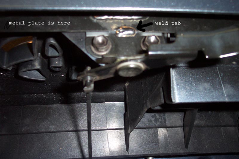

two nuts lost!
Is your weld BROKEN???
I think you have a couple of broken pieces?

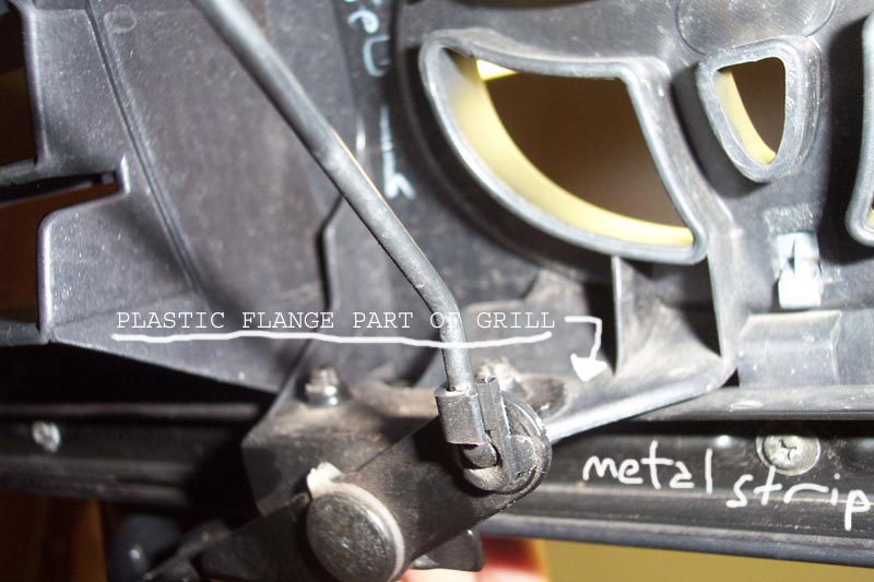

First, the plate that the bolts pass through first is welded onto a long metal strip that is screwed inside the grill. See the picture. I have highlighted it.
mine shows NO sign of EVER being welded ...
that is so weird.
i trust that you are correct, but i'm wondering -- those other 4th gen. owners, is yours welded in that place? is anyone else's like mine and not welded??
mine looks exactly like yours now (i had to take it apart a bit) ... except for the weld spot ...
does everyone have the weld??????????

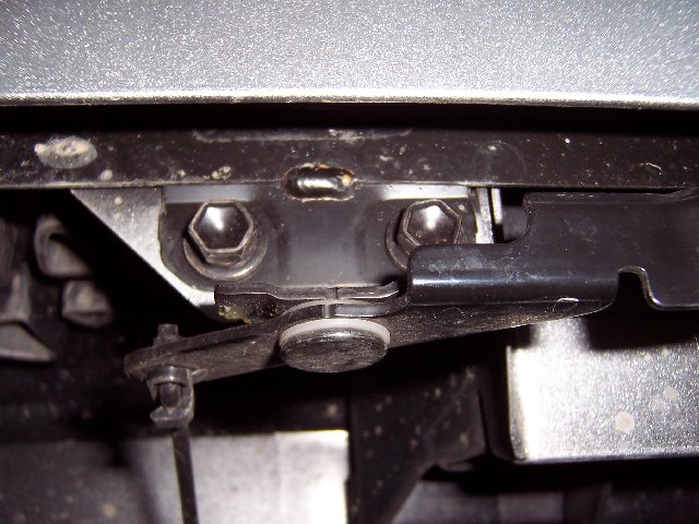

yabedude said:
Mine doesn't seem to be welded either.
Hold on ... I just realized that the weld is underneath ... I also have what seems to be a weld:

HELL yes it's welded..
Absolutely it's welded and it should be on yours AS WELL. Think about it, the latch is only attatched to a PLASTIC flange???? It won't take the repeated closing force and having the strength to hold the hood down.
I think if you inspect closely you will find that indeed you have a broken weld tab!!
EDIT: BUT maybe it was never broken, and just hanging free?? Check the bottom and see if you correctly assembled your hood latch back on? You should have the plate welded to the long metal grill strip

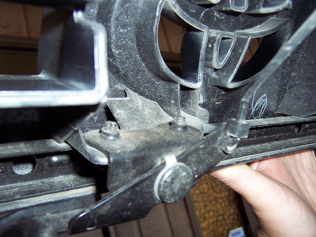

okay, yeah, i do have that weld ... but the weld doesn't actually hold any part of the latch on ... just holds the plate that the screws go through ...
That's good
If the plate is still welded to the strip you're all set, and it's still safe.
WHEW!!
look at your first picture, i thought that weld was on top ... and that's what scared me! hehe!
well, okay, so everything looks in order. though i still do wonder why they took it off, and why it was mis-assembled.
