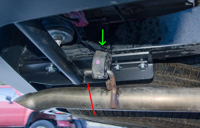

I removed the muffler hanger from the frame mounting spots and rotated it out of the way.

The only thing I can think of is maybe clearance for the swing out if it does angle it to the rear. What is your plan with the exhaust? Warthog seemed to think dealing with it first would be easiest. He's been pretty good at answering questions for me when I PM him, if he's not adventuring today maybe [MENTION=107119]2014 Warthog[/MENTION] can help

check this picture. looks like one of the spacers here more like a washer really. But my guess is the shorter pieces angle, the longer pieces drop
Yeah, you can see the smaller pieces from my picture above. They are on the bottom of the bumper in the two smaller 8mm bolts. The larger bracket in my picture is supposed to go above the bumper and between it and the frame rail as a spacer. It has holes for the 8mm bolts and the larger two bolts.
From getting under there and pushing on it, it looks like there may be a slight taper in the frame so the spacers fill that gap I guess. I honestly think you could also wedge the bumper all the way up to the frame itself too but the bolts they sent for the 8mm holes are not threaded all the way up so without the spacer they will not thread in properly. That said, they don't seem to match the threads well on my truck anyway but the holes could just have dirt in them so I'm going to play around with that in a minute.
