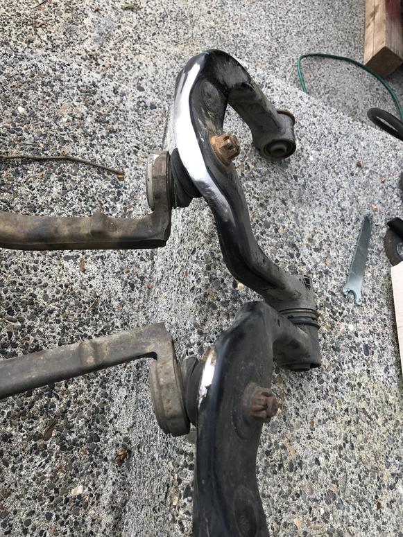

What is your clearance on the UCA with that set up?

Clearance is zero. Well, maybe 1/4" at ride height, but droop causes contact. I could shave the UCA and eliminate rubbing. If/when I get aftermarket UCA's, it won't be an issue at all. If it was an 8" wheel(with 315's), it wouldn't be okay, but the 9" wheel makes the sidewall less-bulgy, and my rub isn't bad at all. It barely kisses the sidewall enough to make a rub ring. IMO it's perfect, because it puts the wheel/tire as close to the pivot point as possible.

Also chopping my UCA while I'm at it. They barely rubbed at droop, but no rub is even better, and I like fab work-
