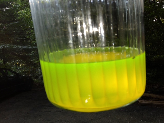

Hey I know where the green came from!
The reservoir isn't red. It's GREEN fluid given a orangish tint due to the yellowish plastic it's in.
Just pulled it out and poured it into a glass jug...bright neon green.

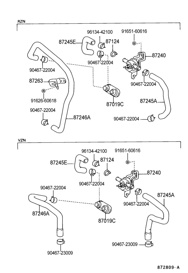

Spent almost an hour trying to pry the remnants of the hose to the heater valve off the line out. There was hardly anything left to grab on to and no room to get a good grip on the remnants. Anyway it finally came off...
Ordered replacment heater lines without the Ts to the rear heater.
Took me a while to find the part numbers, but they are 87245A (87245-35620 ) and 87246A (87245-35730) as per the attached diagram.

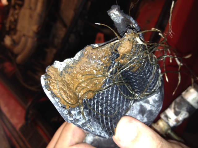

So on to how to deal with the brown goop...

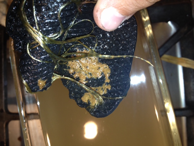

Dunked the hose into a solution of 30% citric acid, the goop dissolved in less than 30 minutes.
The coolant flush that I ordered is 30% citric acid and has even harsher stuff in it - so it should get the job done.
If anyone has better ideas - would love to hear them.

I'm also feeling less worried about the sludge. Attached is what that same sludged hose looked like after 15 minutes in the citric acid solution. That's 15 minutes, just sitting there in cold water, no stirring - you can actually see the bubbles where it's reacting with the acid and the nasty brown acid mix below. At 30 there was very little left and stirring the hose around got the remained of the sludge dissolved.
In short, as long as I am able to achieve full circulation, the sludge will come out with a citric acid flush.

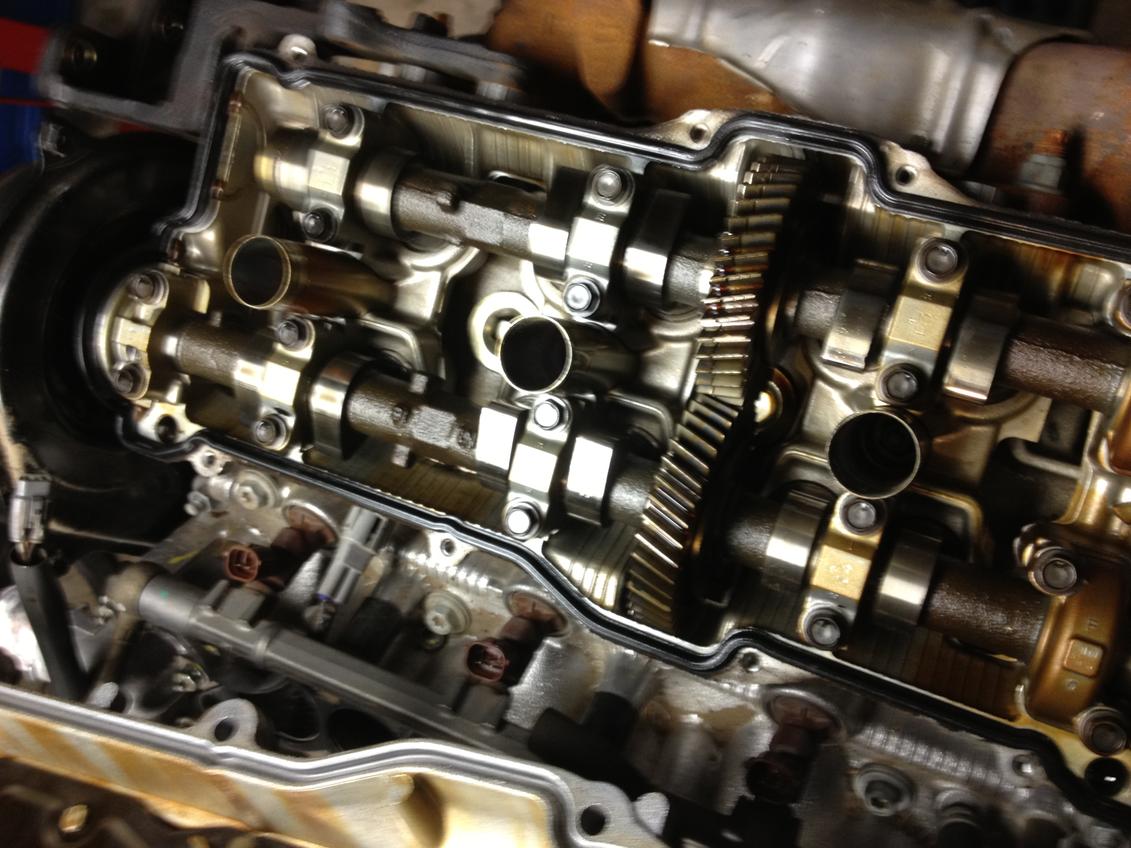

JDM because the engine is essentially brand new. I'm serious. Look at the picture from under the valve cover. Locally, the best US engine I could find was 80k miles for $1,250 + 300 core deposit and zero warranty whatsoever.
Why not fix the headgaskets?
Cost. $1350 gets me a new engine. If my heads are shot, it'd cost me nearly as much as that to JUST fix the heads on an old engine. No thanks.

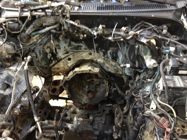

I'm getting really tired of these weekends where I don't actually get to do anything relaxing...but at least the old engine is now out of the car.
Minor setback, the crossover pipe had a seized bolt - bolt, not stud - which broke in half when I tried to remove it. Guessing at some point the PO lost/broke the original stud and replaced it with a crap ungraded bolt that rusted in and snapped... So now I'm going to have to get the crossover fixed up right.
Also - getting the engine to separate from the trans on a manual is a pain. We had to wiggle the crank back and forth while pulling the engine forward. Just trying to slide the engine forward was fruitless, the input shaft would not slide out without wiggling the crank. I kept thinking I missed a bolt as it just wouldn't separate.
Kinda sad to be replacing the clutch too - it's an Exedy which is in great shape. Flywheel is really rough though, not sure it was resurfaced when the replacement was put in.
Really NOT looking forward to be putting it all back in as I don't really know how to ensure that the input shaft smoothly and completely goes into the clutch as I'm trying to put the engine in.
And yeah - that engine bay is disgusting.
