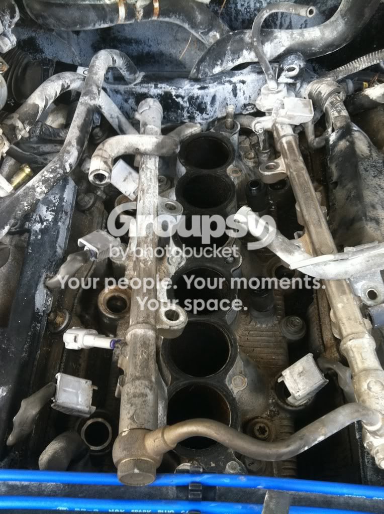

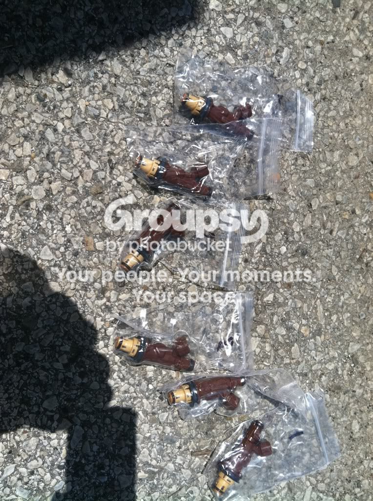

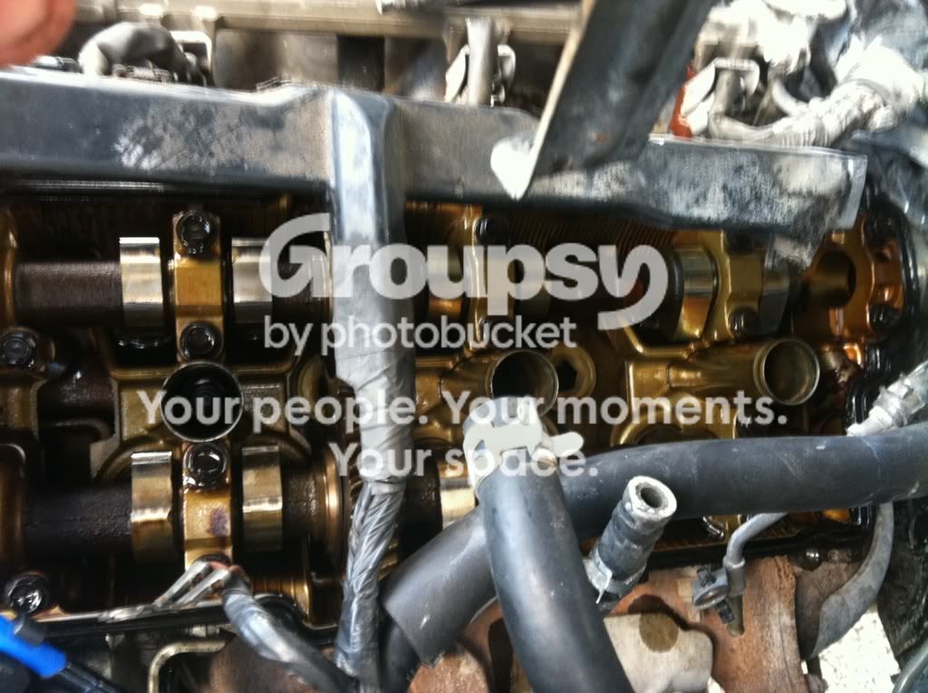

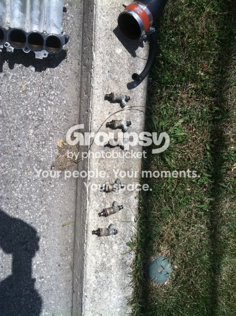

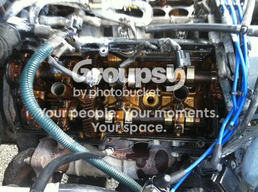

Tyrone had surgery today. Dr. PitBullRescuer threw in new injectors (OEM's I just got back from Witch Hunter) and I decided to replace the valve cover gaskets while I was in there.
94eeca48.jpg~original
Out with the old
03b4314a.jpg~original
In with the new
372993c7.jpg~original
Pretty happy with how clean the motor is. Especially for 222K miles:
19b6bfca.jpg~original
2e598c25.jpg~original
Yeah man. I was very pleasantly surprised when I pulled the valve covers. After seeing Singtoe's update on his I was really nervous.
