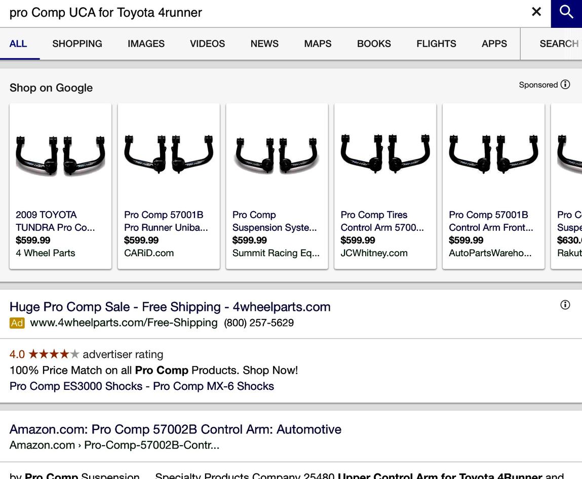

That sounds interesting! Any idea where you saw that info on the ProComp units? They aren't listed on their website that I could find.
Yeah Right here
During the holidays they were going for 430 bucks after all the discounts even Totalautomotive one of the sponsers here had them for like 450 hit them up
There really cool and are actually the ones who recommended them as a choice as I never even heard about them, he said.. they just came out.
