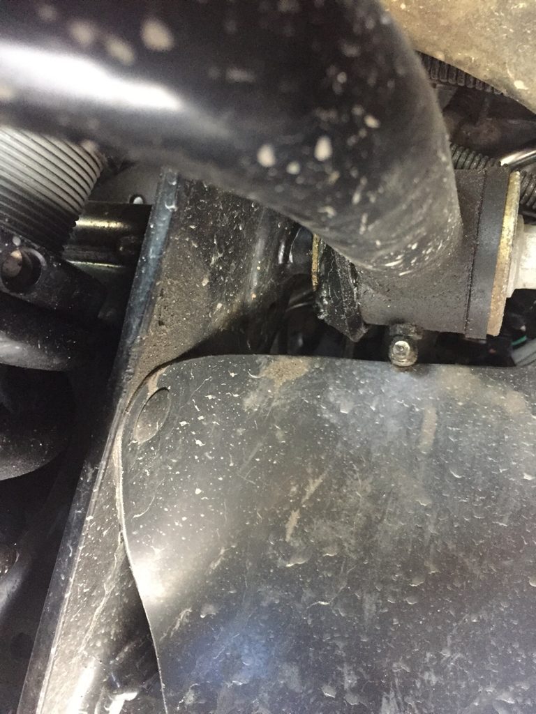

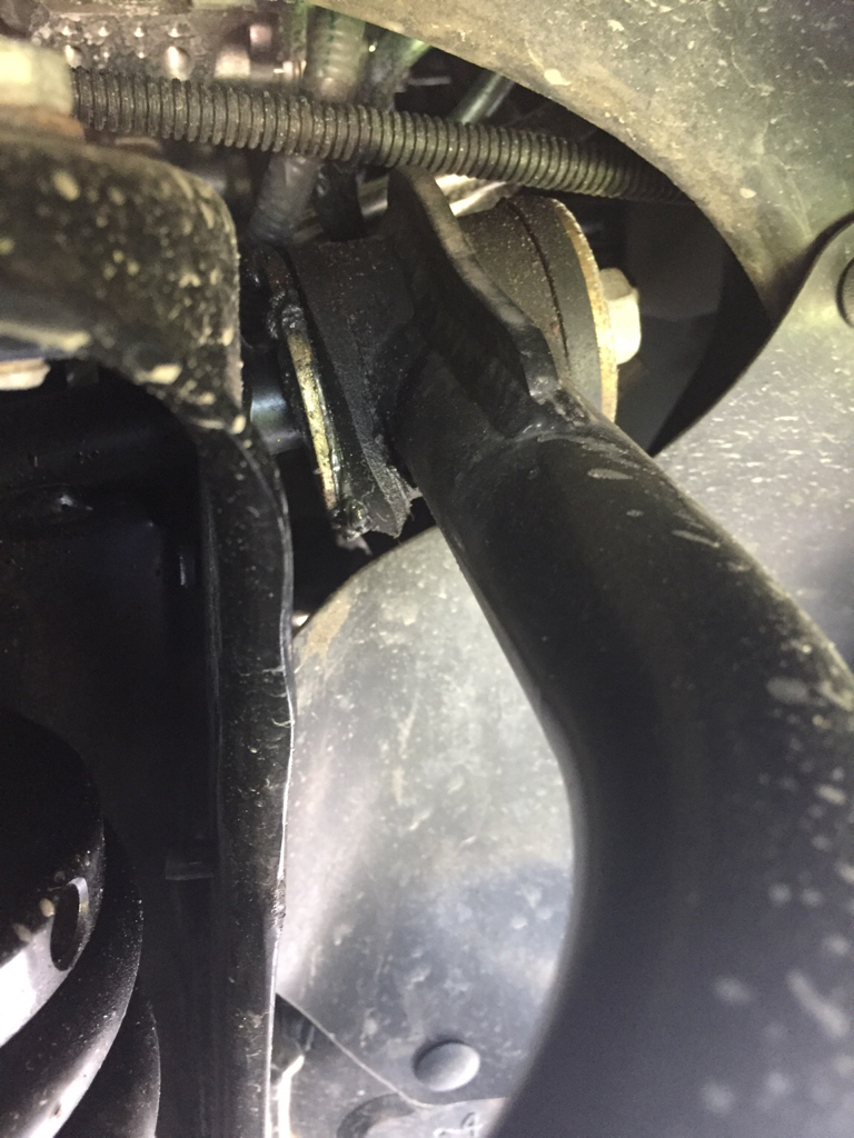

I was inspecting my Icon UCA's because I keep hearing a clunking noise coming from the front every time I put it in reverse. I noticed that my UCA bushings look mangled on both the driver and passenger side.
This doesn't look normal and I've only had the lift on for about 4 months and 7000 kilometers. What could have happened? Bad Install job maybe?
Looks like when it was installed somebody torqued the UCA bolt while it was lifted off the ground. No way will the those poly bushings look like that in 4 months. The UCA bolt needs to torqued to spec while the tires are on the ground or else the bushings may bind and deform.
I'll agree with [MENTION=117117]Seattle206[/MENTION] they look torn from torquing before the wheels were down

So I guess I have to get new bushings and have them installed then? How soon should I get this done and is it really bad to drive with it like this? Also, what brand bushings should I order or does it have to be icon? God I wish there was a reputable shop I could go to in Toronto. Thanks guys.
take them apart and see if they're beyond use. have ICON send you a bushing kit.
it's a pretty straightforward repair, you can handle it :)
Did you by chance put too much grease in the zerk fittings, which can make the bushings bulge out like that? This can definitely happen if you fail to loosen the main long bolt...

Aren't those grease zerks sticking down under the bushings in the first pic? You can see them.

You have zero idea what you are talking about. The zerk for the bushing is CLEARLY visible in the very first picture of this thread.

EDIT: +1 for torqued with the wheel off the ground. Swapping bushings is very straight forward.
Thanks Slowgoat, I think that is what happened here...I think you can even see grease coming out at the left edge.
He probably had some squeaking, took it somewhere once or multiple times, and the zerks were improperly greased.
Thanks everyone for the quick responses and thanks for posting the link [MENTION=104572]Slowgoat[/MENTION]. That is why I love this forum! One more question. Do I have to jack the truck up before I loosen the bolt to get the excess grease out or can I do it with the wheels on the ground? Hopefully I don't need o replace the bushings but I fear I may have to.
Just push in the ball on the zerk fitting and the excess grease should come out

Might be a possible cause.....not loosening the thru bolt first before greasing. They also might have tightened first then greased on the initial install.
