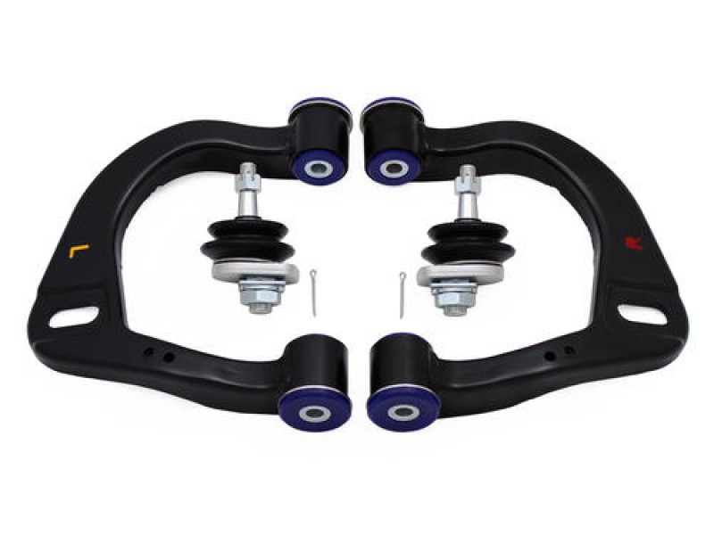

I've been through all the lower cost options except SPC. There is another version of the SPC arm that is a better design, but you'd have to order from Australia. I'd guess they're all made in China. The SPC arm is sold under about half a dozen different brands. They use the same ball joint. But a different arm.
