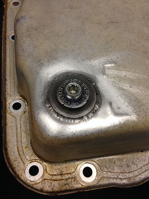

Won't help for tomorrow but-
You can get one of these...
McMaster-Carr
and have it welded into your pan. The pic is from my '93 Chevy c1500. They don't come with drain plugs from the factory so I fixed that issue.
Or get a used pan from a junkyard.
