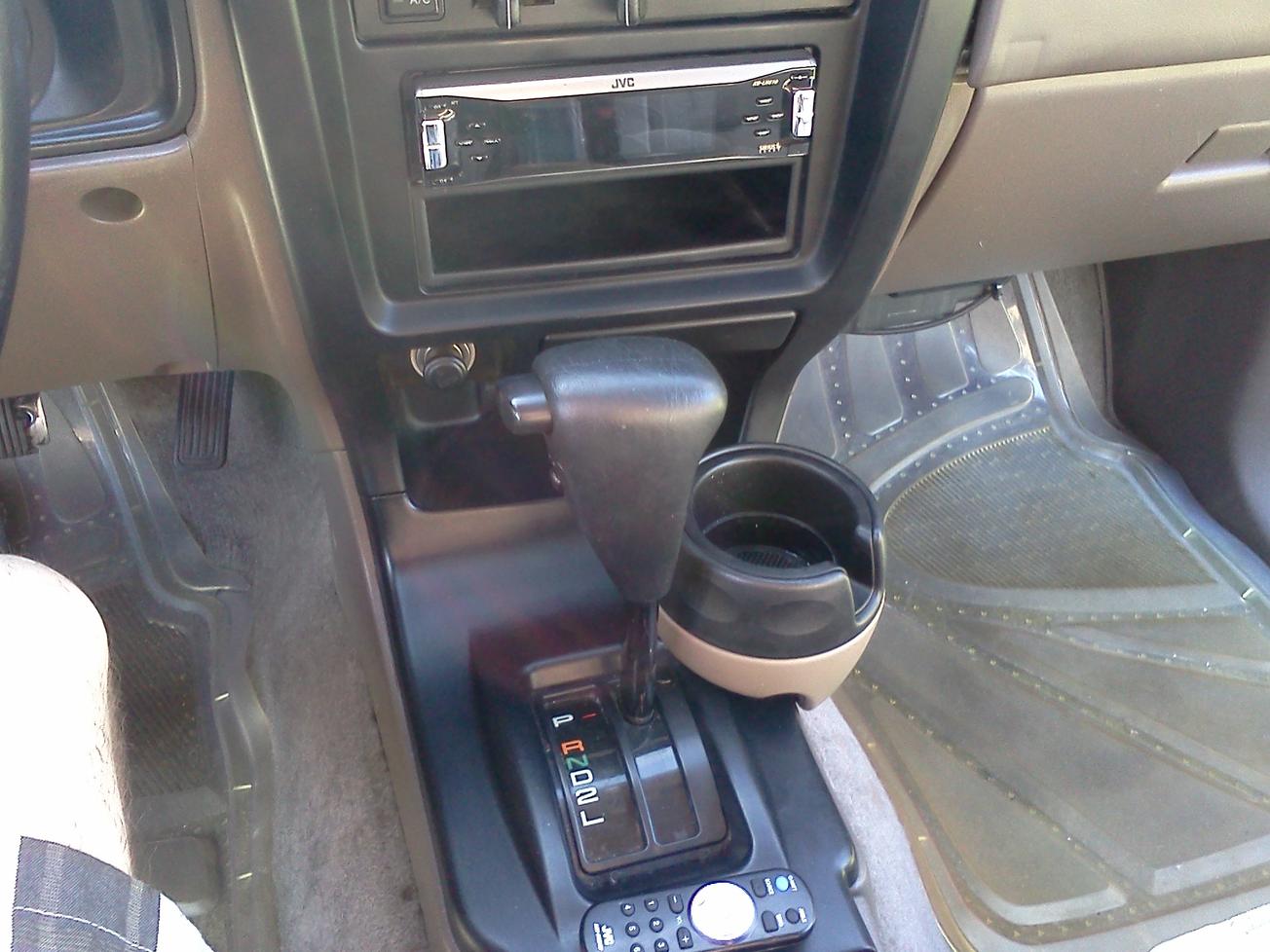

I did the Landrover cup holder thing. LOVE IT! Holds small coffee cups to huge big gulp cups. Not sure if it will work on manual and/or 4wd. Got mine off Ebay for $20. I've seen new ones for $70 ish for two. Maybe order two the re-list one on Ebay if you don't use it....
That's the Disco one I was referring to. It does look pretty nice but I'm just not sure I can find a place to put it. These fischer ones are a little more universal and I've used them before so I know they will work for the kinds of things I drink. I never have a container with a handle on it so that feature on the Disco type isn't important to me. However if you have a 2wd the Disco may be the best solution if you can find it for around $20. Nice find!
