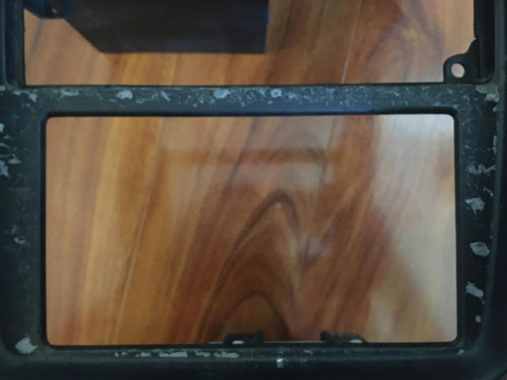

Did you need to offset the head unit a bit toward the driver's side in order to fit it through the widened opening in the trim panel/bezel? I'm going to need to widen it by about 1" in total but there's not 1/2" of material to take out on the passenger side.
Yes you need to slot the brackets and shift the head unit towards the drivers side to center it. I think my Build and Repair thread shows the brackets slotted.
