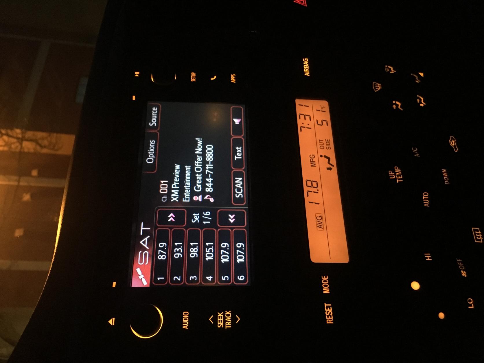

T1819 nonJBL 4th gen - now how satellite?
Ive got a Scion t1819 in my 2005 nonJBL 4runner thanks to all the good instructions here. Great sound.
What do I need to add "factory" satellite I can control from the t1819 head unit?
You will need the factory SAT module and the antenna and the cabling between the module and your radio.
