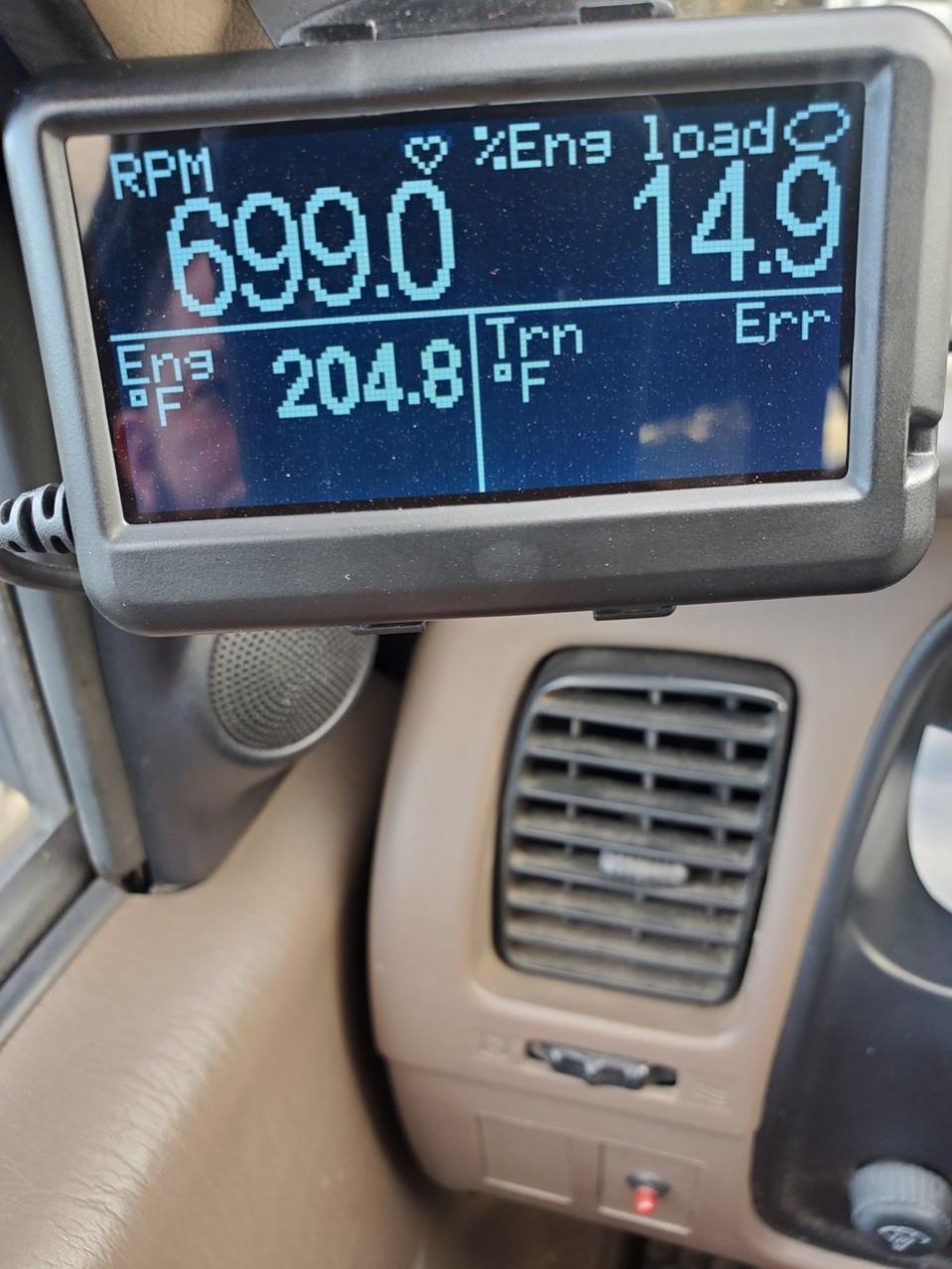

Any way to monitor transmission temperatures with the ultragauge?
Posted is a picture of the settings for a 1st Gen Tacoma but ECU differences must be why I can't monitor it -

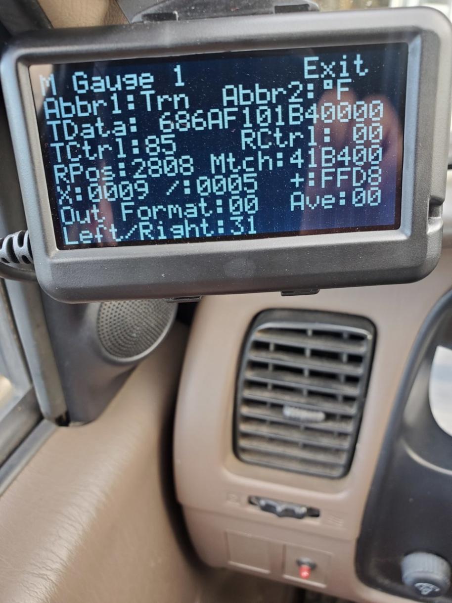

The code you entered is correct. The transmission temp can only be read through OBD2 on model years 99+. What is your model year?
Here's the setup for transmission temperature for 99-02 4Runner's for anyone else that's wondering
TData: 686AF101B40000
TCtl: 85
RCtl: 00
RPos: 2808
Mtch: 41B400
X: 0009
/: 0005
+: FFD8
Out Format: 00
Ave: 00
Left/Right: 31

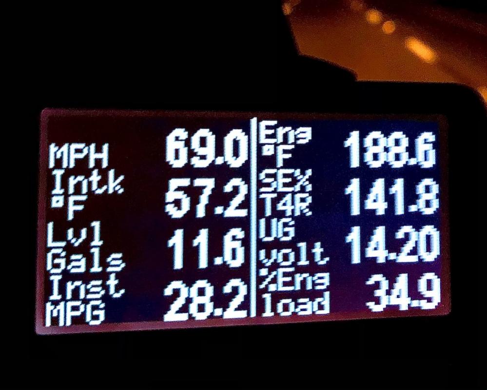

Doin 69 with a hot tranny?
Sorry to barge in here, but thanks to the above info I finally got my UG displaying one of the most important functions I originally got it for. I could have been more creative in hindsight, but those were the first two 3-character strings that popped into my mind when naming the function. Now I need to find the healthy range (?) and see what it does climbing the local mud/snow trail in 4L

Is there an idiots guide walkthrough on where to enter that info? I also originally bought mine to monitor trans temp but have instead spent my free moments doing other electrical stuff :D
Navigate to the page below on the device and you will see how you can set the parameters. It's a bit tedious but you'll get the hang of it quickly. It helps to have the info shared above printed and with you. I did it while waiting for my son's dentist appointment. I Googled Ultragauge Mgauge Programming or something on my phone.
Menu > Gauge/Page Menu... > Select Gauge/Page > M Gauge Setup.
Select an unused MGauge page (I used 1) and start pushing buttons to edit fields.
Voila!
Viola!
