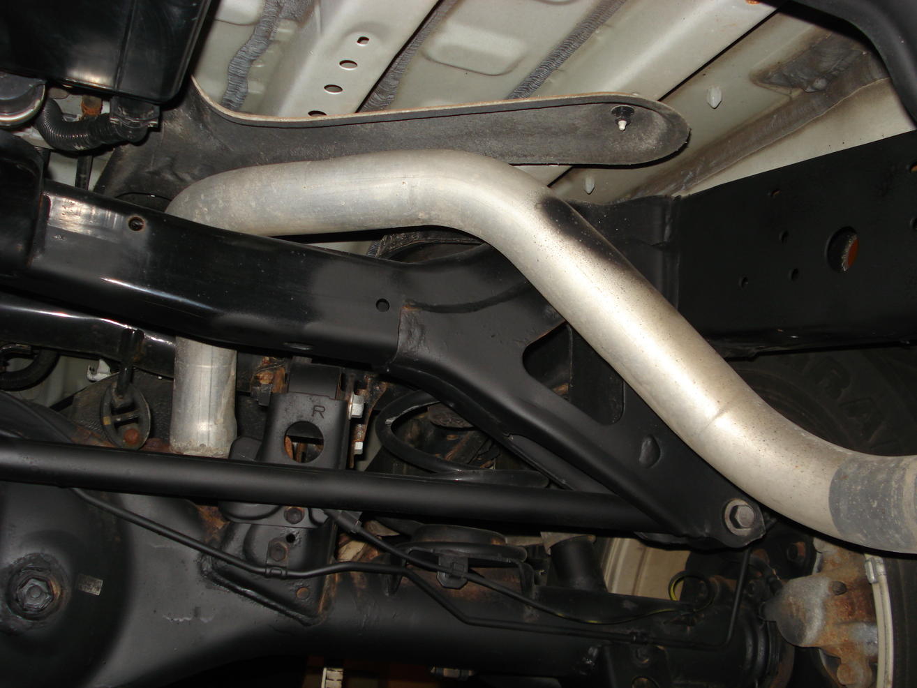

I just finished undercoating my 2008 that I purchased used with 32,000 miles. I've had good luck with applying the rust convertor and then using Truck Bed Liner spray paint. The Truck Bed Liner drys non-tacky and if any rust develops underneath, it pops off and lets you know where to focus during semi-annual inspections. The attached picture is during the application of the rust convertor. I went back after this picture to get to the small spots I missed. After 24 hrs, I applied the Truck Bed Liner. Looks nice and clean now. Best regards, Doug

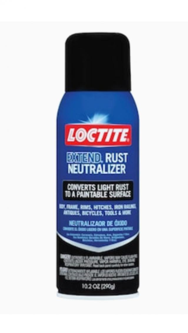

My neighbor recommended a product called Loctite Extend Rust Neutralizer.
It turns surface rust into a black neutral surface that can be painted. He used cans, but I bought the spray “paint”.
I don’t have a long term review, but so far, so good. My neighbor highly recommended it. He used it on his car’s exterior. I’m working on my 4R frame.

Can you apply por15 after using the Loctite product?
Member “<<<<“ pretty much answered your question. POR15 and the Loctite product are both rust converting primers, so you wouldn’t spray one on top of the other. The Loctite instructions say to use oil-based paint over it.
