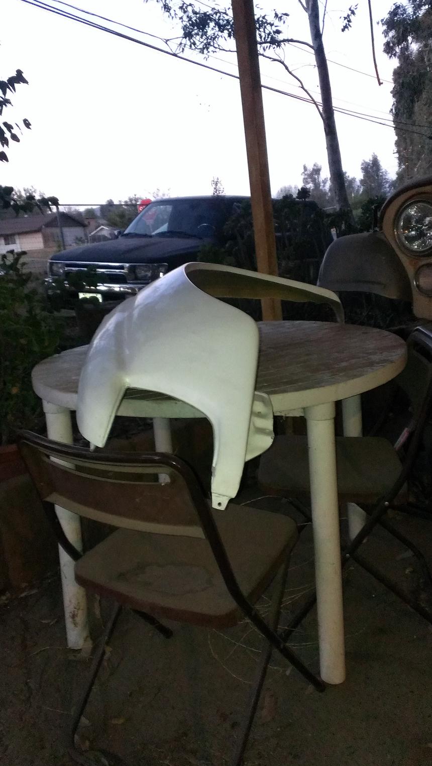

Glassworks unlimited also makes front fenders for our generation. I picked a set up a few months ago for mine.
How did you find them for our generation? We're they listed online or did you call in for them? I can't find our gen on the site and I'm about to order 1st gen Tacoma ones
I have tacoma fenders on mine but the alignment isn't exactly right. You have to use tacoma corner lights and the hood doesn't line up correctly. The tacoma fender drops about a half inch more then the 4runner fender.
