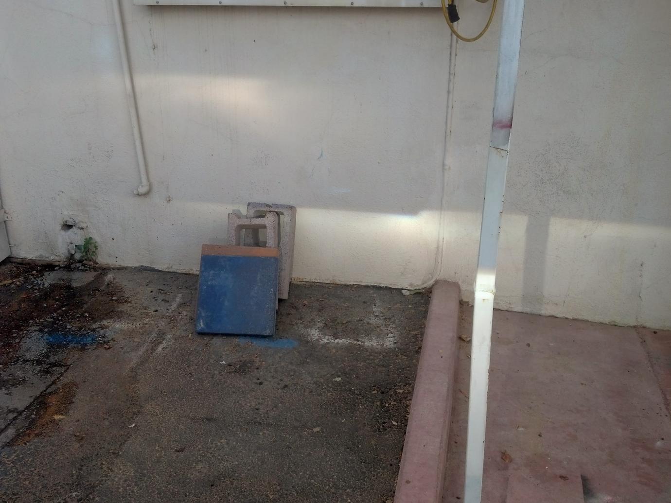

The picture below shows on the left a 50 watt hid pnp in my stock reflector, hids typically put out about 4 and half times more light than the equivalent wattage halogen. on the left is a 50 watt hid bulb inside an fx-r projector, the difference is huge. The optics of the projectors are hugely more efficient than that of a standard multireflector headlight, even considering the fact that the projectors actually cut out the light on the top and bottom to produce a sharp cuttoff and also to eliminate the foreground.
Sorry for my semi off topic rant but I figure after all of the research ive done someone searching the intertubes will probably find this information useful, also If any of my information is wrong please feel free to correct it.
