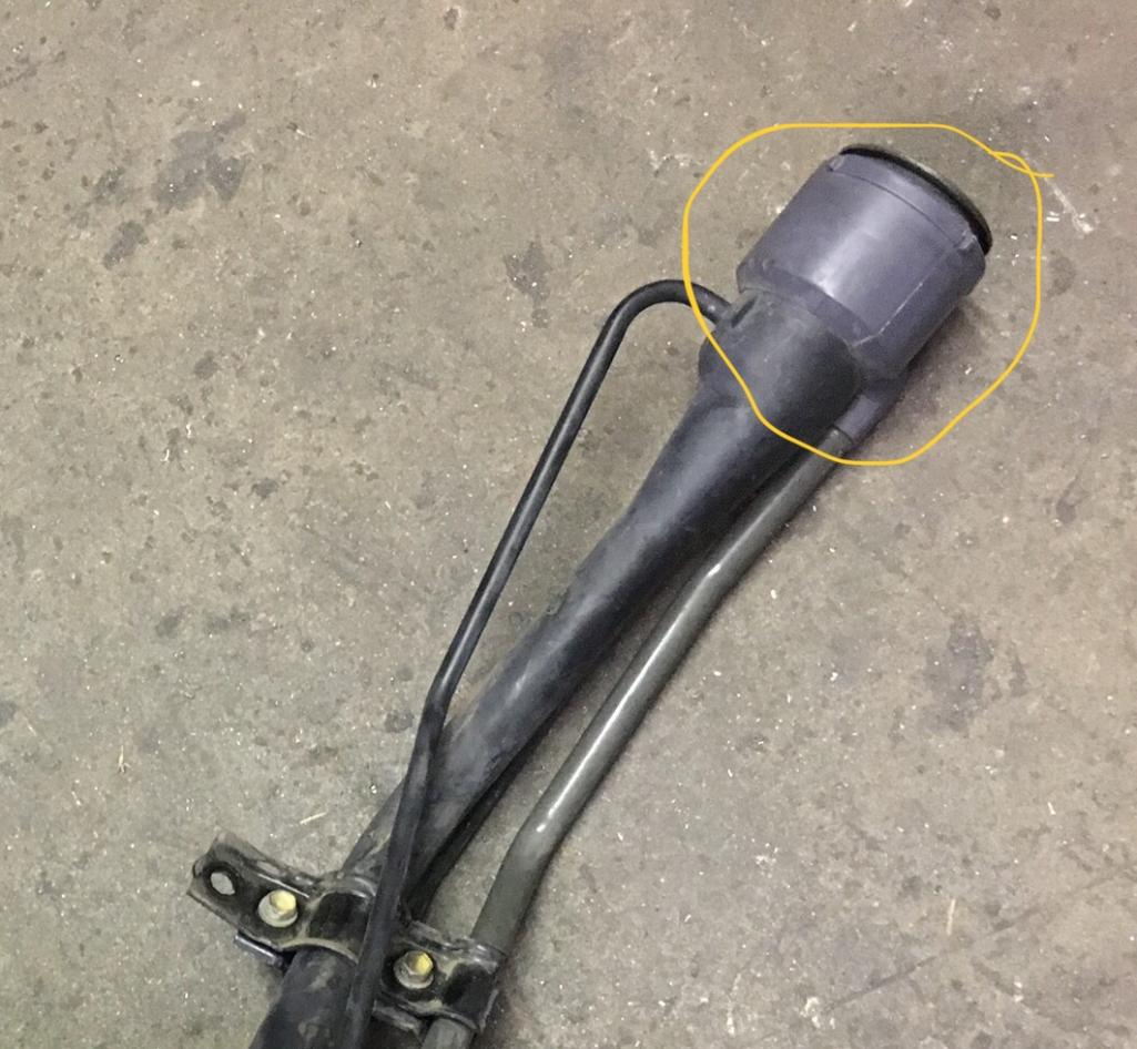

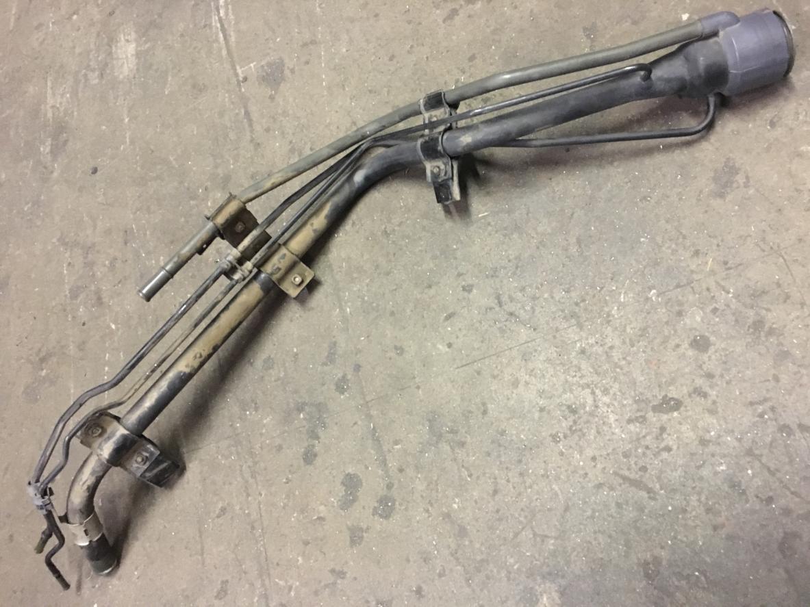

After removing the old neck and inspecting, I’m a bit concerned that nothing is wrong with the filler neck. As T.Tech quoted, I did not realize that the larger vent tube is not directly sealed to the filler neck. It’s just slipped into the plastic sleeve that wraps around the head of the filler neck and moves freely.
Which in turn may be where the smoke was leaking from during the smoke test. *♂️
I did not remove or plug the vent hose during the test because I was under the impression it was sealed into the filler neck.
So now I’m worried that the check engine light will again go back on, My Girlfriend will be upset for having to buy more parts, and I’ll have to probably get try again with the Charcoal Canister. Then do what T.Tech suggested and check the Roll over valve.
T.Tech, would it more likely be the roll over valve or the Charcoal Canister?
The Vent tube on the filler neck is connected to a valve on the Charcoal Canister.
I’m posting some pics of the old filler neck and circled the plastic vent sleeve.
